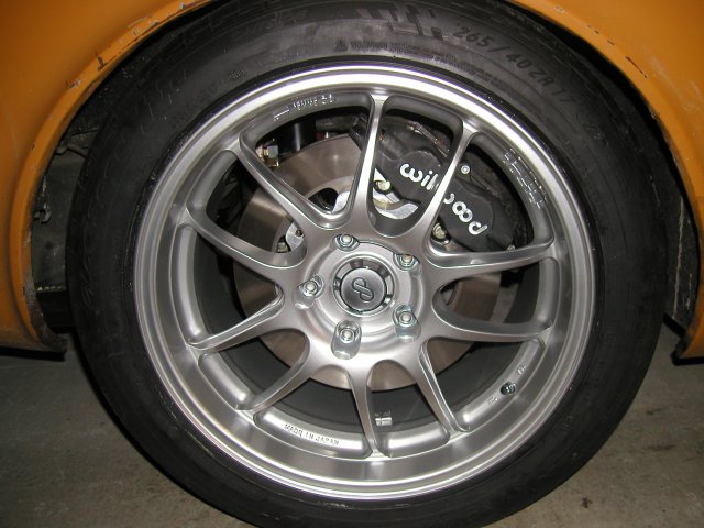

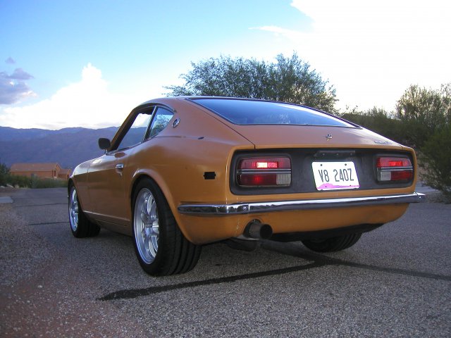

I originally wanted the RPF1s but, after talking to the factory, I found out that there wasn't enough clearance between the spokes and my rear calipers. My rear calipers stick out a full inch farther than the wheel face. The PF01s are made with extra clearance for big calipers. Now I'm glad it worked out that way. Here's a side view of the right rear. Mike Mileski Tucson, AZ -

Here's a shot of just the wheel from Enkei's site. I'll take a couple of side shots of mine later and post them. Mike Mileski Tucson, AZ -

I just installed a set of Enkei PF01 wheels on my '71 240 this past weekend. 17x8 fronts and 17x9 rears. It is an awesome looking wheel. Mike Mileski Tucson, AZ

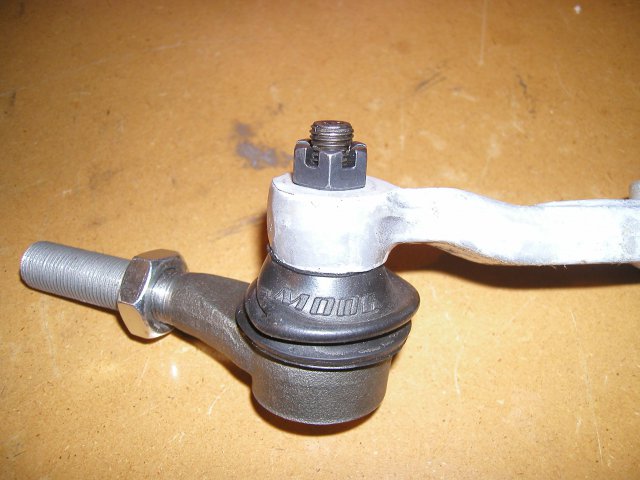

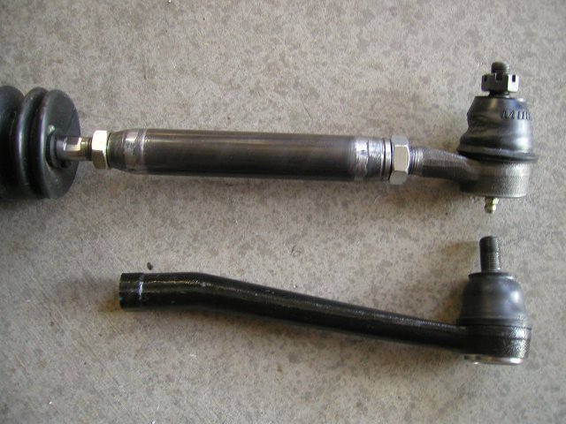

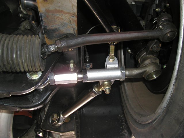

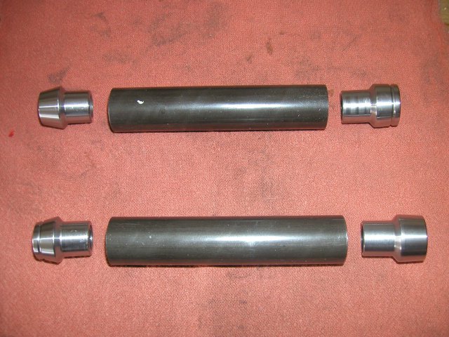

I bought a steering rack for my 1971 240Z from Motorsport Auto a couple of years ago and decided to install it and make some adjustable tie rod adjusters for it at the same time. However, I wanted to find a pair of standard tie rods that had the same tapered stud dimension as the stock Datsun so they would fit into the stock steering arms PLUS have one of them right hand threaded and the other left hand threaded. I went to a good old fashioned auto parts store that had a thick Moog catalog, which listed top and bottom taper diameters and started my search. After a while I found a pair of tie rods that fit 1963-1982 Corvettes. ES323R (inner passenger side) and ES323L (outter passenger side). ES323R has a 5/8-18 right hand (RH) threaded shank and ES323L has a 5/8-18 left hand (LH) threaded shank (see pic 1). The taper dimensions were within a couple of thousandths of those listed for the stock Datsun, even closer than the ones listed earlier in this thread. The stock Z steering rack has a 14mm-1.5 LH threaded inner tie rod on the driver's side of the steering rack and a 14mm-1.5 RH one on the passenger side. Since I already taps in both of these sizes, and I liked the style of the threaded tie rod tube ends made by Summit Machine, I ordered a pair of their 5/8-18 threaded ones, one RH and one LH, and, since they didn't sell metric ones, a pair of 1/2-20 ones, one RH and one LH. I drilled out both of the 1/2" ones with a 1/2" drill, which was also the tap drill size for a 14mm-1.5 thread. I then tapped a 14mm-1.5 RH thread in one and a 14mm-.5 LH thread in the other. (see pic 2). I purchased one foot of 4130 tubing (1" OD X 3/4" ID)and cut two pieces to the appropriate length. The tube ends slip right in and can then be welded (see pic 3). I may put some flats on the tubing so they can be turned with a wrench but they turn so easily by hand that I might not. Check out the remaining three pictures for some more details, one has the stock Datsun tie rod in it for comparison.

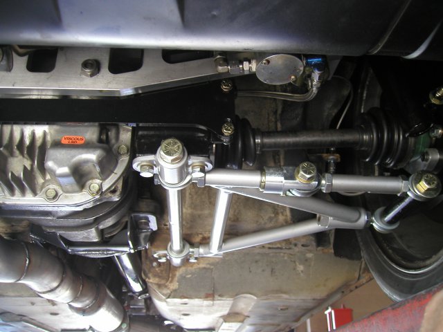

Chevy ZZ4 crate motor G-Force GM T-5 transmission Z32 TT R230 differential, axles and hubs Techno Toy Tuning rear suspension custom front and rear control arms 4 wheel Wilwood rotors and calipers Mike Mileski Tucson, AZ -

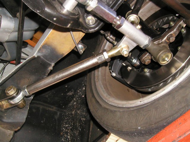

I also made a set of rear arms just for myself that I won't make any more of that I hope to have on the road pretty soon. It is the floating arm in front design (that has been race tested by someone else on the forum already). It uses heims instead of bushings for the inner pivots and the adjustability is great. I'll be able to give more useful information in a month or two. Mike Mileski Tucson, AZ -
