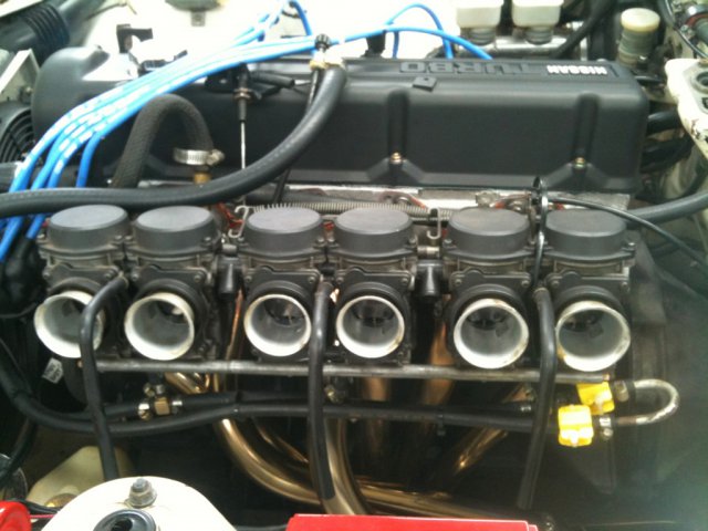

Here's my engine bay with the old blackbird setup and now the current FCR41's. DIY L29 with PMC worked P90 head. -

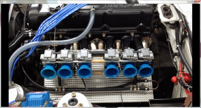

It's all helpful information, thanks. Current stacks are the standard Keihin radiused type 50mm long, maybe ill just keep those. I have never dialed in the cam properly (74deg works grind with high lift) so that could also be a factor with the Stand off. I should look into that before I make any drastic changes, I'll be getting a new oxy sensor this week for the air/fuel meter, this should help to get it pretty close jetting wise.
Thanks Leon. I said choke which was the wrong term, the actual wording was more linear flow with less turbulence. Basically I thought it would work like this... When the throttle is opened low-mid way on the FCR's the air coming in hits the slide, drops vertically to go under the slide and then continues on. With conventional butterflies the air would seem to have a straighter, smoother path at low-mid throttle. Thats my very simple logic, seems like I have been fooled by the snake oil I already bought two of those stacks cheaply, I might give them a try anyway to see if they get rid of the 'stand off' I can see at around 2-3,000rpm.

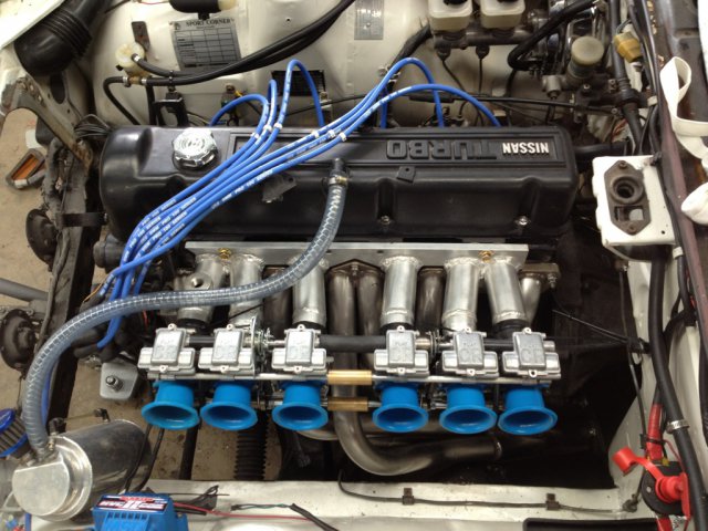

Got these babies on and running, engine runs quite nicely. My oxy sensor is dead so fine tuning will have to wait, plug color looks spot on! Check out the video's in the members video section.

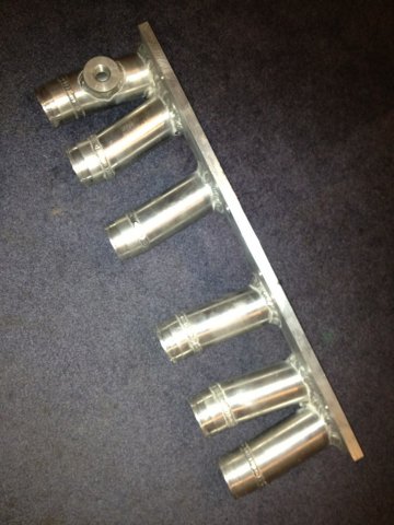

Here's the new manifold, with the carbs test fitted and plenty of clearance all round. I have a question for the velocity stack guru's.... I have come across a 'power now' stack (see pic below). The velocity stack is fitted with a horizontal plate across the centre, when the flatslide is open on low to half throttle the air is only drawn straight throught the lower section. This is meant to promote higher velocity,less turbulence and give better driveabilty. I guess it's acting like a choke at part throttle, at full throttle it has no effect. It claims to increase power/torque in the low to mid range rpm. My shift point is 7200 so I figure thats low-mid range. The theory behind these seems to make sense but I'm wondering what you guys think? Thought I'd keep it all on one thread. Also to correct I have adjustable main air screws and have just fitted adjustable idle mix screws for east tuning. Thanks, Gareth.
