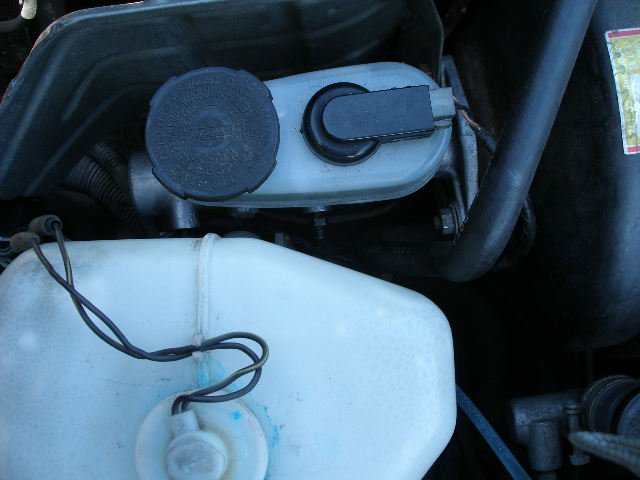

interesting I never really compared the 81 to the 83.
thats off an 83 the 81 and earlier had the same metal but the reservoir tank is differnt - two separate tanks
maybe it is due to the coriolis effect down south. seriously they face out and to the left if you are sitting behind the wheel. best pic I can take without removing the heat shield and the spare is too hard to get to but you can see the little rascal peeking out between the mc and washer tank if you squint
check the website zccw.org for activities. 280 only got one line from plenum to the waste gate. run a line from wherever you mount the boost controller to the where the plenum line is now connected (this is your inlet). Run the output line from the boost controller to the waste gate. we mounted the one on my son's z31 to the left front fender where there were some convenient mounting holes. You basically have a pressure relief valve which instead of exhausting to atmosphere exhausts to the waste gate actuator. thus your waste gate stays closed until the pressure relief valve lifts and puts pressure on it. As presently configured the waste gate gradually opens until full because there is just one line going to it from the plenum. If you can't figure it out from that drive over to my house and I'll show you. you can check out my new z31 turbo
there are two and on left hand drive they face out towards the fender. They are on centerline of the cylinder (90 degrees alignment from the brake lines)
