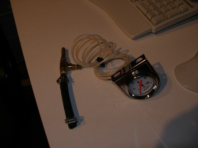

first off cheapest thing to do is change the fuel filter probably $10. next get some fuel line hose, hose clamps, tee and a pressure gage. Probably run you under $20. put the tee in the fuel line after the fuel filter hook the pressure gage up to the open leg on the tee. See picture. what part of WA are you in? Check our club zccw.org plenty guys willing to give advice come to a meeting
well we could take a guess at what type Z you have for a start and then guess at some other things but if you had done some diagnostics like knowing the fuel pressure there are things that could be eliminated. when you hit the key does the starter engage and the engine turn over but not start. your post is not clear on that point.
