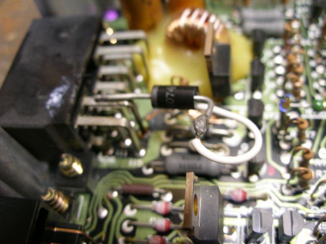

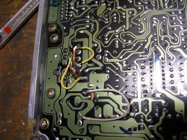

  2. you might open the junkyard dizzy and check the innards. Look for burnt diodes and/or conductors on the board the have scorched. I have had success by running a piece of 22 ga stranded to replace blown board conductors. Replace diode if burnt. Need a 25 watt solder iron and electronic duty solder. anything heavier than 25 watt do more damage and no repair. pic of one that I resurrected.

  13. no telling what they are from your description but yes having injectors with different flow rates will not make your engine perform at top efficiency.
  14. bsp (british straight pipe) threads and NPT are compatible except for 3/8 which is 18 tpi and 19tpi (and the smaller sizes you never see on cars). BUT you can pipe up 3/8 and usually get a leak free joint. The 1/2 inch is the same for both and you can thread them in just fine. you have to understand the difference in taper threads and straight threads which if you did a minimal web search you could find quite easlily.
  15. ugly sure but at least it works now. still don't know what blew the diode tho.
