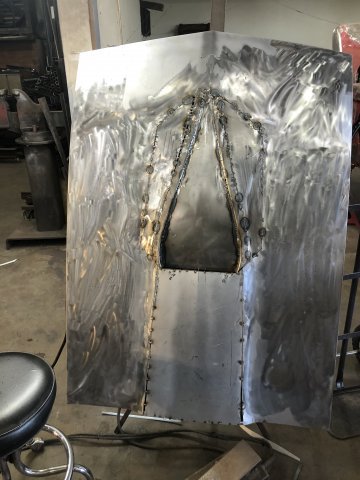

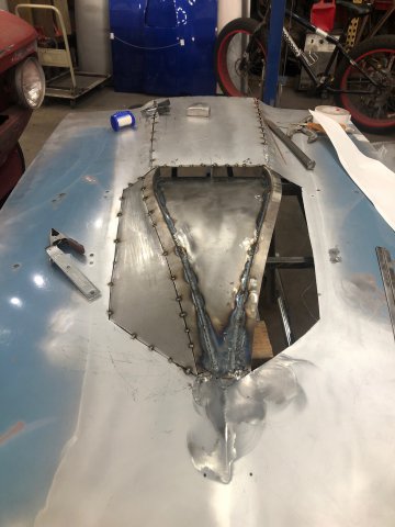

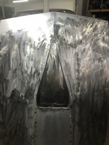

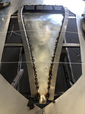

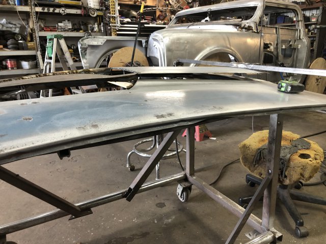

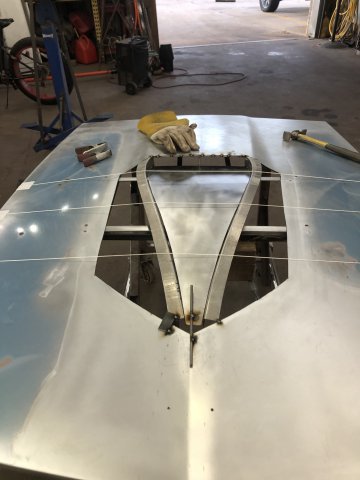

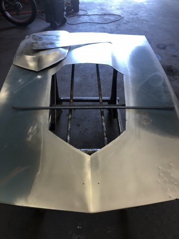

I knew I had an issue with my fiberglass hood mounting flange (where it bolts to the hinge) hitting the cold air intake. The mounting flange is super thick in comparison to the stock hood and it hits the intake. Some say why not redo the cold air intake but I just like the way it came out so that's not an option for me. I have been trying to come up with solutions and still use the same hood since I like the scoop. The scoop is not massive plus I don't see this type of hood on a lot of S30's which is a big plus for me. Nothing worse than hearing, I know someone that has one just like it after you spend tons of money trying to make your car unique. So I decided to purchase an used stock steel hood and have it modified to look just like the fiberglass hood. This is the progress so far.

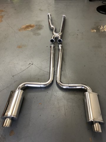

Since my car is in paint prison I decided to remove the exhaust and have it ceramic coated and re-polished the tips. This way I feel like I'm making progress.
