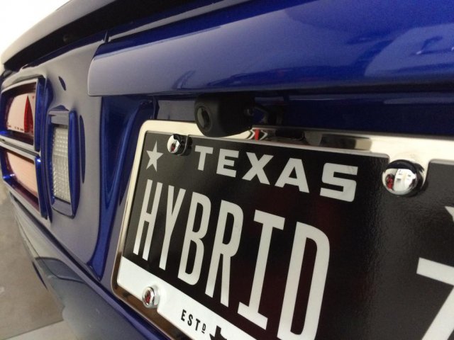

Thank you sir. I installed my Kenwood back up camera that will work in conjunction with my display screen on the receiver.

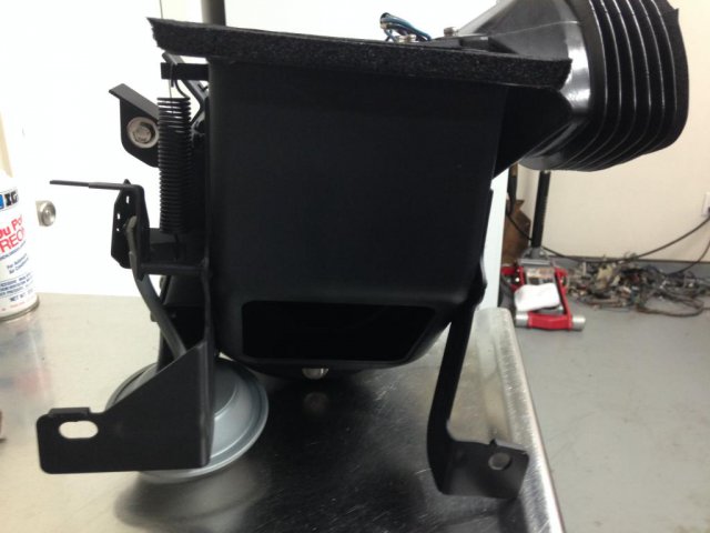

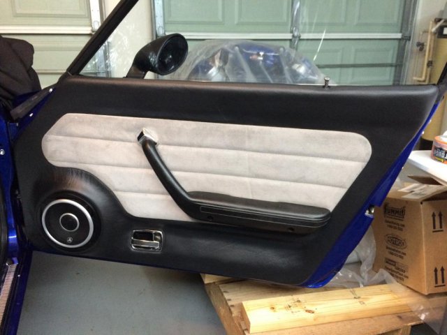

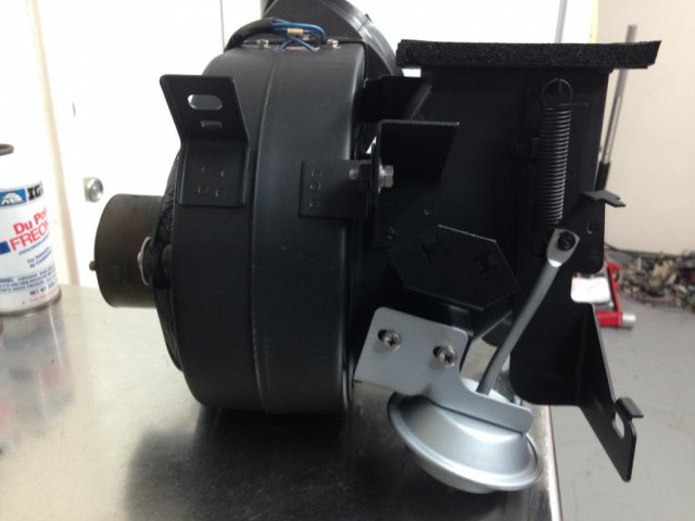

I know right, I'm still waiting to take the car to the fab shop to have my brake, fuel and nitrous tubing installed. These guys are really busy and just can't seem to get me in there, I call them every week so they don't forget that I'm waiting on them. I have called around to others like Powerfab, 3D performance etc.. and they don't want to do it. The problem is the double flare on the stainless tubing for the brake lines. As soon as I mention that they all say the same thing. NO because doing double flare on stainless is a PITA. I can't install the motor until I get that done so now I'm at a standstill. Hopefully I can get the car to the fab shop in the next 2 weeks but I have been saying that for over 2 months now. In the mean time I have been doing little things like running a tap down every threaded hole to get the primer and paint out of there. I was surprised how long that takes. I also went through the blower motor assembly and refurbished it. I may install my door panels this weekend but really for the most part I'm done for now.

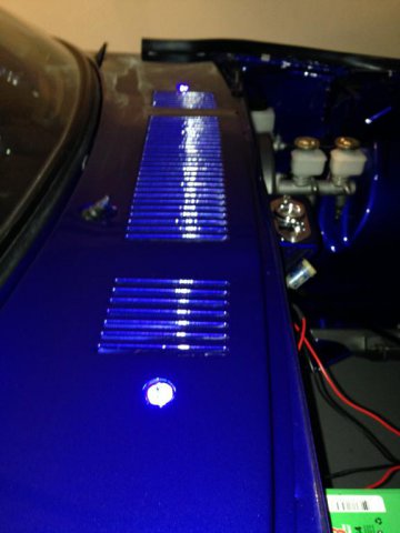

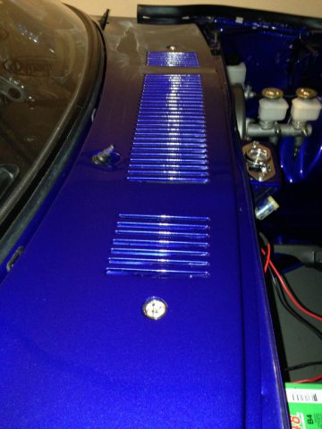

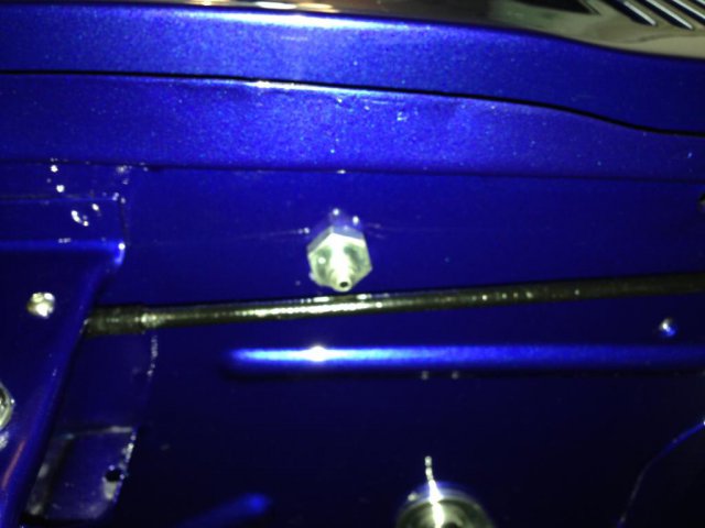

Got the Nitrous purge done. Two Nitrous purge kits with blue LEDs where installed in the cowling. I was not able to take the car to the fab shop to have my brake, fuel and nitrous tubing installed and I had to go out of town on business so I will have to wait until I get back. Another set back but at least I'm making some progress.

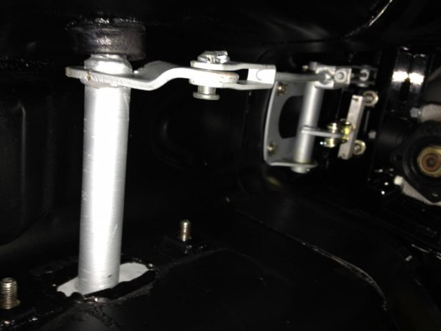

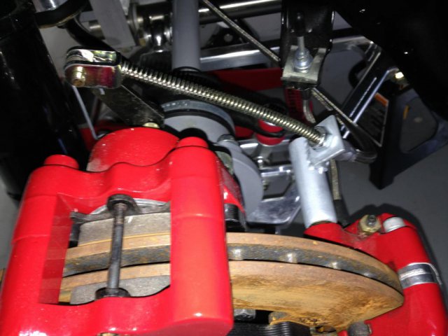

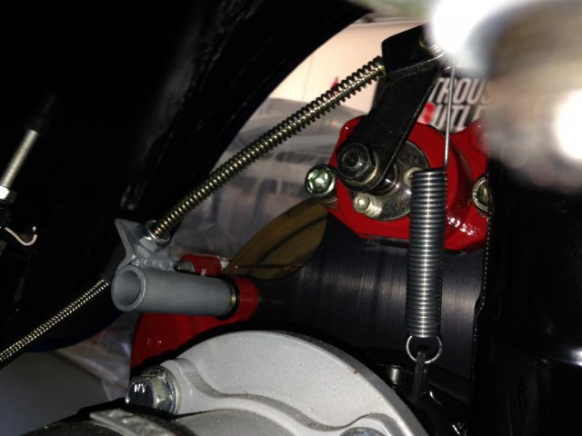

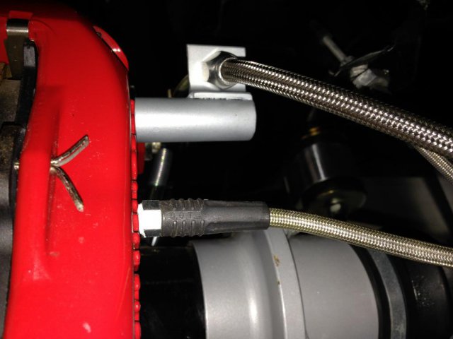

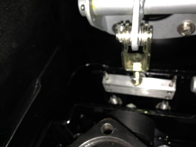

LOL, I guess there is a little bling on this car. Just finished the hand brake cable on the Arizona Z parking brake. What a PITA this was. Purchased a Lokar universal stainless braided parking brake cable kit and had to modify to fit. Also had to have some brackets made that will hold the cable at the caliper and if that was not enough I had to source some springs to return the brake cable back to its original position once released since the Lokar set up its not strong enough. Finally everything works as it should. Time for some Whiskey....
