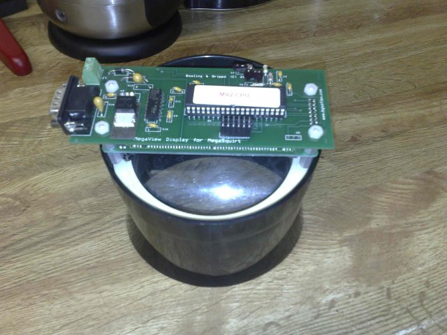

  7. I was thinking more along the lines of smoked plexi between the megaview and the tach pod screen, this will only allow the screen digits to be viewed.....I made a tinted plexi screen to go in place of the radio but then decided this would be a better idea. I will probably use that static tinting stuff you can use on windows . I think one of those 4 way mirrow joystick switches would be good for the contol switch.

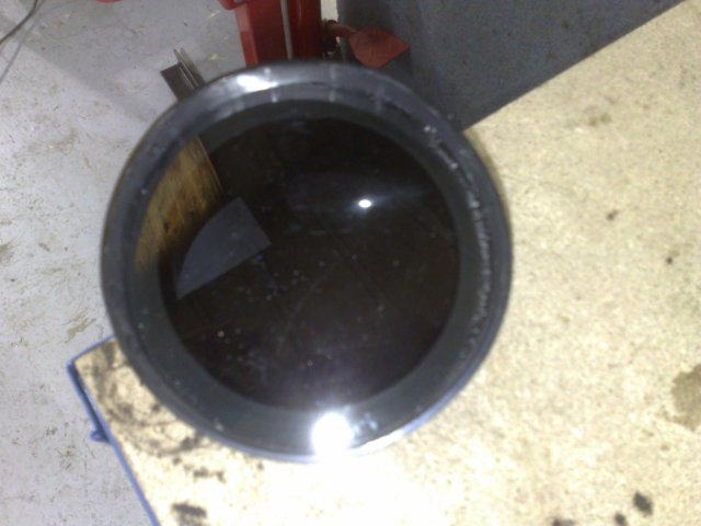

  8. Need to add some tint on the lens but you can see how it fits. good idea about the indicator LED's....a shift light would also be good.

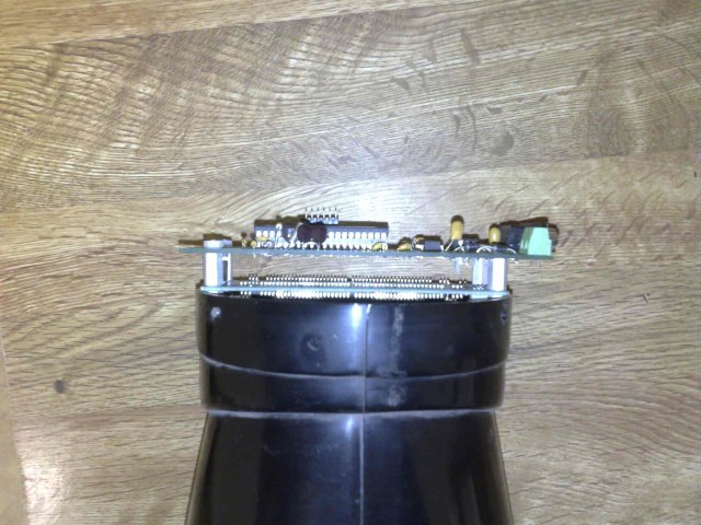

  9. After removing my dash i have been thinking about options for my Tacho as the old one won't work with MS. I've decide to use a tinted perspex lens and mount the mega view in the back of the tacho pod. The screen just fits inside, will post some pictures of it later tonight.
