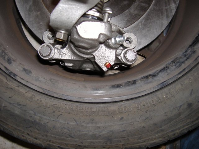

The 240sx caliper slides on two guide pins. After installing the calipers I noticed that the right side caliper had some play in the guide pins. I could move the right caliper up and down slightly. The left caliper is tight and can not be moved up, down or side to side. So I went back to NAPA and exchanged the right side caliper for a new one. After installing the new caliper it also has the slight up and down movement. Is this a problem or normal for floating calipers? Thanks Miles

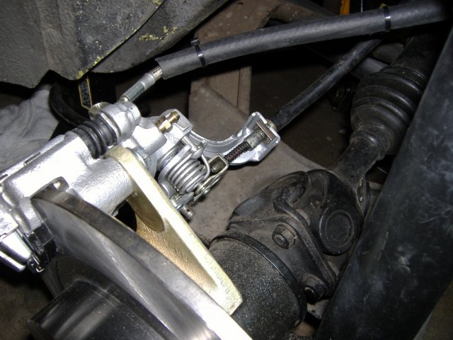

Here are some pictures of the modified E-Brake bracket installed. The cable fits perfect. Pulling the E-Brake handle up locks up both calipers. -

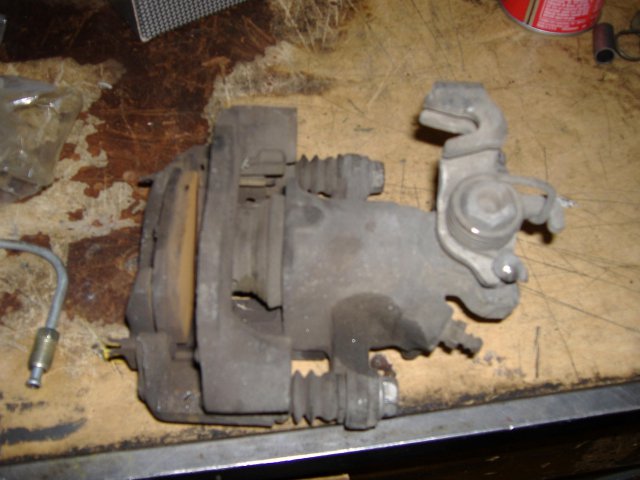

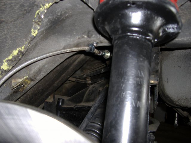

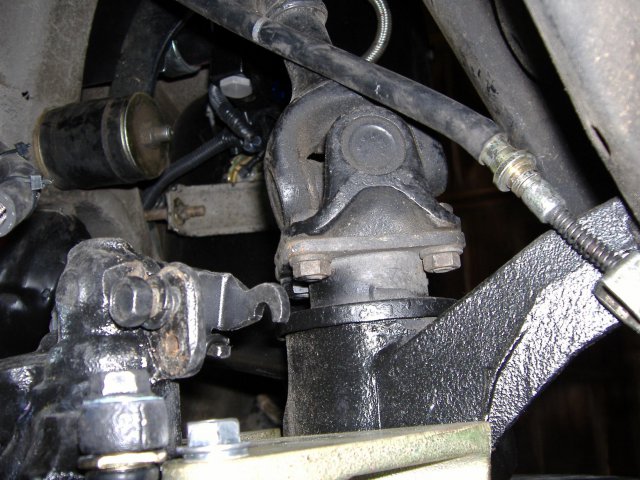

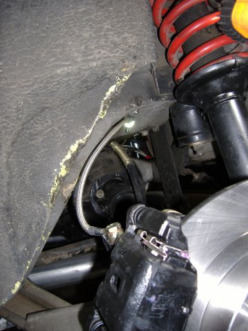

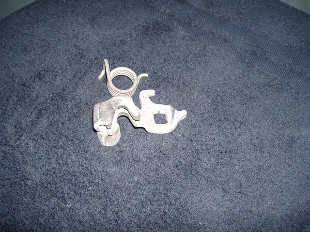

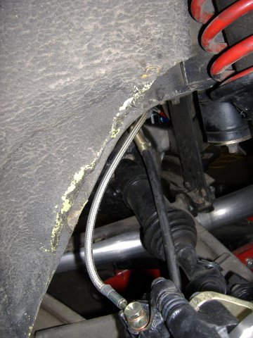

I haven't hooked up the cables yet, but they do look about 1/4" short. I could make a slightly longer adaptor if the caliper becomes too preloaded. I am running into a lot of little problems I didn't expect such as the driver's side flex line looks like it will rub on the frame (see picture). Also, my cam arm where the e-brake connects is just a hook (see picture). I have an old set of 240SX calipers that has the correct cam arm that I plan on swapping the cam arm to my new calipers (see picture). Miles -

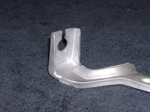

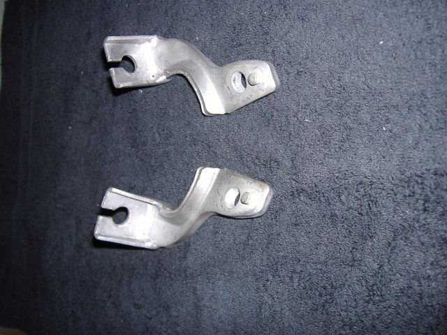

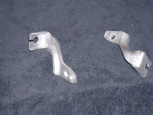

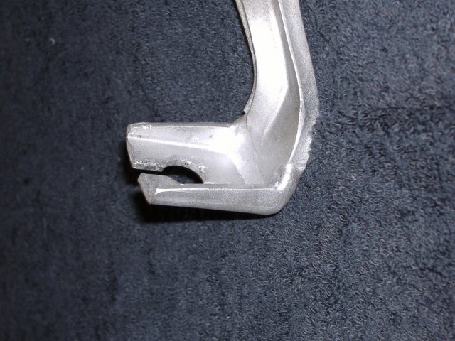

The 240Z E-Brake cable has a smaller diameter then the hole in the 240SX E-Brake cable bracket (Hanger). The 240SX bracket is also thicker than the 240Z bracket making difficult to use the the retaining clips in a reliable way. So I had a shop weld the 240Z E-Brake bracket to the 240SX bracket as seen in the attached pictures. This should result in a more reliable (stock) mounting for the E-Brake cable.

I just installed a MM 240sx brake kit on my 240Z. There are two issues 1. Driver's Side Flex Line: I installed the 20" hard line that goes from the T block on the passenger side to the driver's side and used the SS flex line that came with the MM kit. The geometry and length of the flex line makes it fit very close to the frame and will most likely cause it to rub on the frame. I am thinking about getting another flex line the same length as the passenger side that Ross supplied in his kit. A longer line should allow it to droop below the frame, but not so long as to hit the half-shaft. From my search of the archives I see others have had this same problem and have just installed a flex line all the way to the T block. 2. E-Brake Arm on the 240SX Caliper: I bought 1994 remanufactured 240zx calipers. The problem is that the e-brake actuator lever that connects to the E-brake cable is completly different than the pictures I have seen here. On mine the lever has just a hook at the end. It looks like the letter "J". there is no way it will capture the fork on the end of the E-brake cable. I do have an old set of calipers I bought for core charge. See attached pictures. The new caliper is black. Miles
