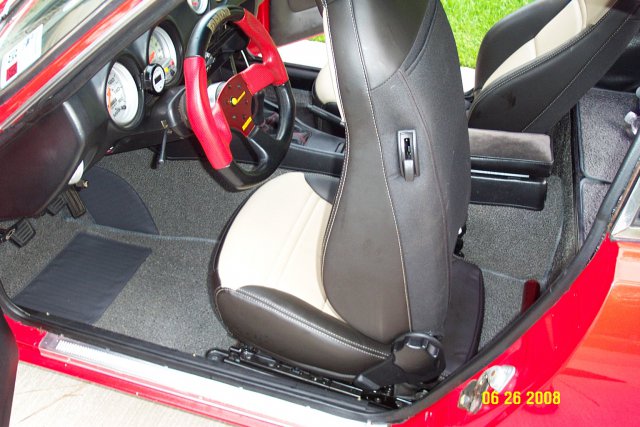

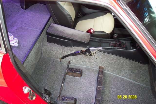

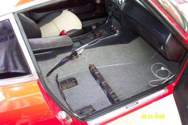

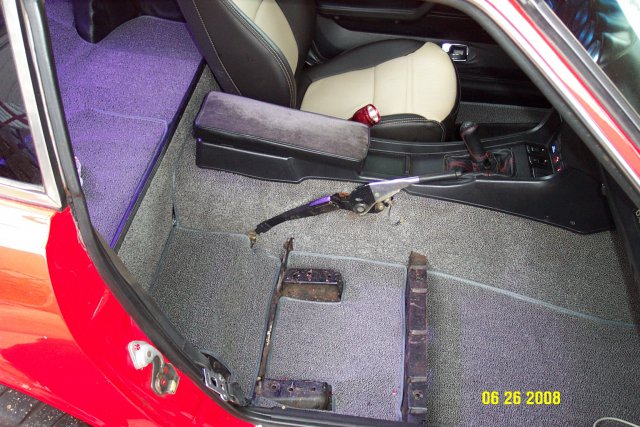

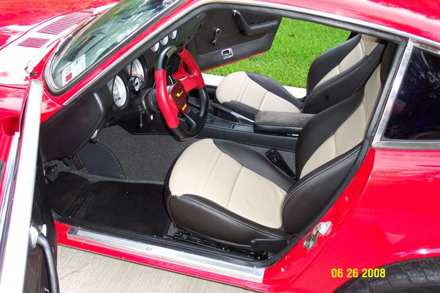

Thanks Gabe. I like the carpet too.... even though I had to have them re-cut the pieces under and right behind the seat. I just made him a pattern, and had the new 4 little pieces the next week in the mail. Great service from Ben's Auto in Newark N.J.. The rubber kit came from VB. I used a hand held hole punch (for paper) to cut the 1/2 circles out of the bottom edge on the door seals, so water would drain out from under the rubber. They did close kinda hard at first, for a short while. Appreciate that!! The only thoughts I've entertained, was swapping the black door panels, for a Tan pair. But I'm pretty sure the tan on the seats, would be a different shade than the tan from our older Z car interior.... Thanks, I'll let you know if they become avail.
Thanks Evan! the tan really washes out when I try and take a pic to show how nice the color actually is. The seats really are not a black leather like advertised. The are a deep dark chocolate brown leather (almost black) and the center is almost a caramel/tan leather. I thought I would regret the purchase due to the color, but its growing on me now....
Yes, they are noticeably higher than the DADs seats were. If I lean the back half forward, the top of the head rest hits the sun visor slightly. They could stay this way though, if I wasn't so used to my legs being almost extended strait out with the other seats. It actually made my calf muscle go into a spasm while working my twin plate clutch, and that never happened in the other seat position.
I finally got around to installing my new leather seats I stole off eBay for $152.00 > http://cgi.ebay.com/ebaymotors/ws/eBayISAPI.dll?ViewItem&ih=009&sspagename=STRK%3AMEWN%3AIT&viewitem=&item=190227827139&rd=1 They really are designed to be installed onto the floor. I did not want to go through the removal of the seats brackets welded to the floor right now, so I just put them on top of them for now. It makes them around 3 inches higher this way, and I can not use the driver side electrical seat height adjustment, due to the head rest hitting the roof if I raise the seat any more. They will do as is for now, until I feel like removing the seat brackets. I think the colors kind of break up the all black look I had before I put the gun metal carpet kit in, and the blk/tan seats. I think it even goes good with the red paint... whata you think??
