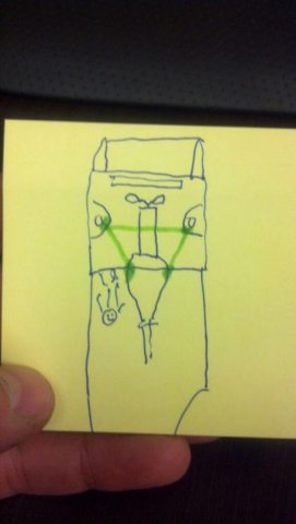

I'm going to run one across the struts. Then one each going back to the firewall around the area where one of the intermediate reinforcement ribs is. About 6" to either side of center or wherever that longitudinal rib (is my plan...) Hoping to not just create a pivot point at the firewall. So I made a precision drawing... -

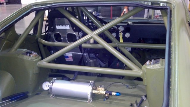

So much left to do. Gotta finish setting ride height and then mount flares and race tires / wheels. FOR SURE the fenders are cut high enough now LOL after finally pulling springs and doing it the right way on the 3rd go. Nets are in, seat and belts good, brace done, Accusump mounted, got to finish wiring and plumbing.. I consternated for weeks about where to put it and finally just drilled a hole and it was easy from there. Oil Line will go dong through the floor, over diffy, under tunnel into engine area.

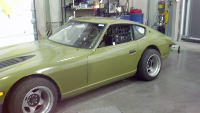

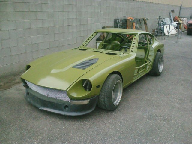

Finished 3 months of fabrication work turning the Z into a dedicated NASA "Race Group" legal track car. Today, the painter comes to start 2 weeks of paint work and I cannot be happy enough ... Many thanks to my flock of helpers for putting in so much time to get all the work done.

Mounting Accusump day... this is a dedicated track car. I'm thinking of mounting in back bay by strut towers. Any reason not to? If it has nuisance leaks I will be pissed, but should be able to seal. Steel reinforced hose meets tech and I just don't imagine too much pressure loss on a 15' section of 3/4" hose. I can't stuff it under the cowl without more cutting. I have a passenger seat... Under dash hard to service. How am I doing so far? I wish I had the balls to mount it on top of the roof "Ghostbusters" style..
