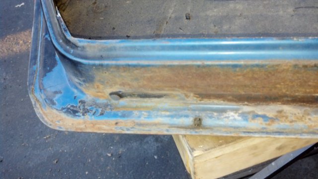

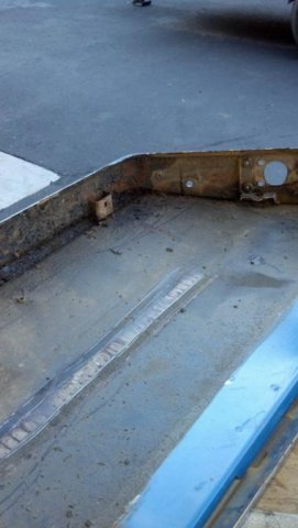

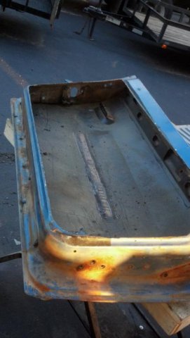

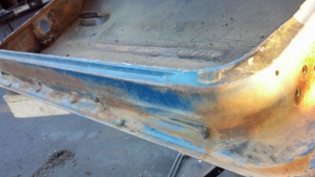

Wow. The doors. Nicest doors I have ever seen. They have some black crap sprayed inside. I stripped and gutted one of the doors last night and it is rust free (I almost feel bad). Also very light. * Gutted bare door at 18 lbs. * Hinges seem lighter as 1.5 pounds and 2.5 pounds Gutted to 18 pounds and still has paint and tar spray and mud inside. Ok. Now lets discuss the hatch. It is pristine Gen 1 vented hatch with vertical defroster. I would make it available to somebodys project with a proposal and suitable empassioned plea...

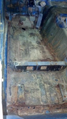

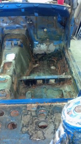

Well, its not "rust free" but virtually so I would say. Nothing is free as you know. Floorboards and front framerails will still be replaced and tire well cut out.

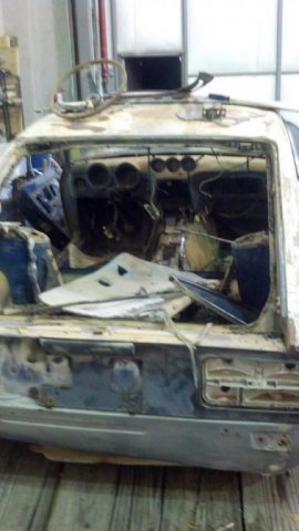

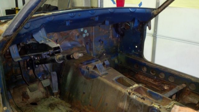

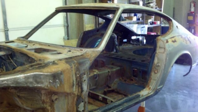

Y'all are familiar with the Green Machine, but today I acquired another Z (#4 for me). This is HLS30-06367 (June 1970). Donated by my good friend Jon "Speedgato" from Desert Datsuns Arizona way. My Green Machine was born green and will always be that way. This car was born Blue and will always be the Blue car. Corsair blue... And will become another dedicated track car. It will undergo a full race-car transformation and drive again as it once did. Thank you Jon, and thanks to the Desert Datsuns gang for all their help over the years. And "Special" thanks to Chris Dowers who devotes so much time to my projects. You really are a "Special Person". Now, what you've all been waiting for... Remarkably little rust. Some damage up front and possible impact damage in the back. All will be easily fixed. Only Z I've ever come across with NO / ZERO / NONE modifications to it. Bone stock. lol:
