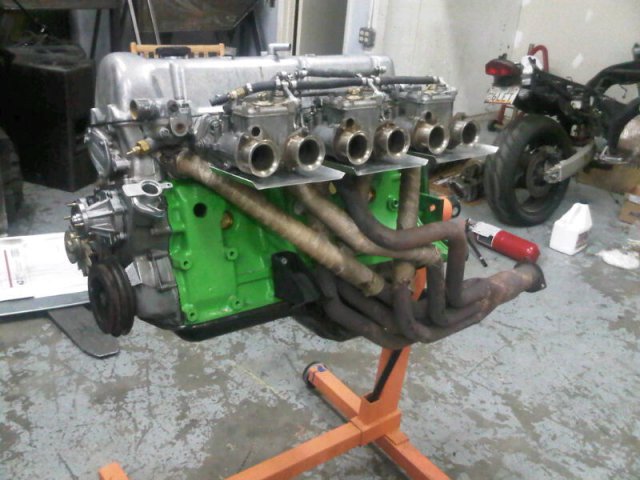

  3. I just built (myself) an L28 with a slight overbore and N42 head with triples. Still dialing in an breaking in. But its a cool motor. Growls and pulls cool. However Denver is going to really hurt you with the density altitude. Get the most displacement you can. For me the extra stretch for a stroker wasn't viable. I didn't find any great deals on stroker cranks, and the head gasket required was looking to be pretty expensive too. The delta to get past 2.8L in cost didn't make sense for me so I did the best I could on 2.8. So far my Isky L490 regrind is treating me well. It was big enough to be fun, but not so big that it required tower shims valve cutouts and such. Do your homework real well like you are so you don't get any big surprises. With flattops and an N42 head they say it puts you in the detonation danger zone. I haven't hammered the motor hard enough to hear it yet. I also installed a Wideband O2 sensor which is KEY for dialing in Triples. And installing a KnockSense detonation sensor this weekend. Slightly overkill for an NA car but these things are relatively cheap.
  4. Interesting input. I am Normally aspirated with Triples and a Wideband and now this Knock Sensor. The motor is 10.3:1 which they say is knock prone. Phoenix air induction temps are a bit high. Will get it installed this week and find out! TJ

  11. Just did this. I wanted a 240mm flywheel and the Arizona Zcar 12lb steel unit wasn't in my budget. So I bought a new 240mm flywheel and had my machine shop shave it down to about 18lbs. I did buy the Arizona Z-car pressure plate and organic clutch. Mostly because he lives near me and I just drove over and picked it up. The revs are amazingly snappy. But it does require some re-training on driving to keep power in the driveline when starting off. Daves entire setup is pretty sweet with LFW, PP and Clutch.

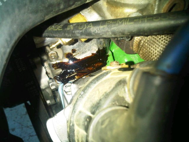

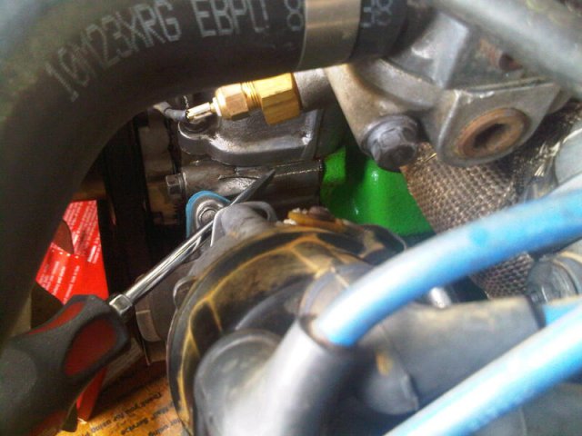

  12. Great call on clear silicone... Why do I always seem to get the message about 3 hours too late? I am not proud of this... I covered the lower and upper case vents and put a shop vac on in the oil fill hole creating a vacuum. I could feel suction by the leak so the hole is pretty big (don't really want to talk about why it is there.) Then I used Gasket Shallac and let it draw into the void. Shut down the vacuum and goooped over the area about 9 more times just to be sure. Having fun again now! A couple of battle scars aren't no big thing. Tj
  13. I suppose that is easier than pulling the motor / head and all. Thx.
  14. Got my new F54 / N42 running. Oil leaking at the sides of the top of the front cover where it meets the head. The tip of the screwdriver pinpoints the spot. Similar but smaller amount on the other side. Don't think I can torque those front screws anymore - Fraid of pulling them out. Does this mean a do-over?

  20. I probably should have done an L6 build log somewhere other than Hybridz as there ain't much hybrid about it. Motor is done, adjusted ready to install. Spent yesterday and today overhauling the Fs5w71B with new syncros, bearings and seals. Spent another day today wrapping headers and applying heat shield to the new heat shields and trying to keep the temps away. That L6 is a pretty crappy design with the headers licking the intake runners.

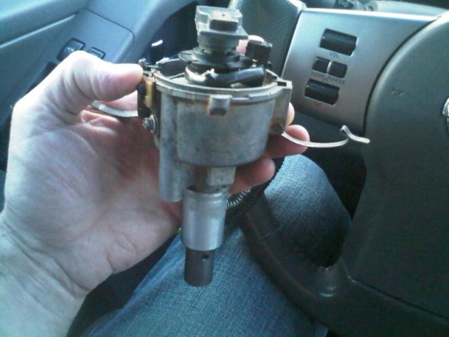

  23. Cleaning up loose ends and waiting for .160" lash pads which are NLA. MSA shipped me .230s which I will have ET Grind to size on Monday hopefully. Then a quicky OH on the Tranny and start the final stuff. Still have to decide on which clutch to get. Have to cut down the flywheel. Install the O2 Sensor bung and buy the WB Need motor mounts, ugg. Still some money to be spent here...
