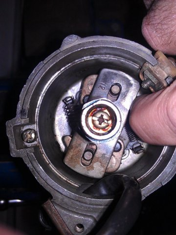

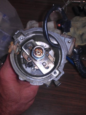

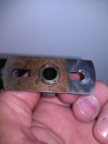

Pictures. The weights. Except for different springs seem identical. The shaft. Yes, by design it has different slots. But somebody has welded the shorter slot shorter. My issue with this is that when the first weight hits its stop, the other weight is free to continue tugging on the arm. It can't go far, but it can probably bounce around enough to making the timing dance a bit. Machine shop has the parts and they are going to weld and recut so the slots are both equal. Both weights will be on their stops when the advance is all-in. If (or when) this doesn't help or make it worse you an all laugh at me and say "we told you so noobs".
Those pictures are all a "dual points" dizzy. I have a single points dizzy. Would like to compare FSM pictures of the two. FSM says they have different centrifugal system.

Hard to see in the picture, but one slot is closed down a bit and the other is standard length. So when the first peg gets to full advance, the second is still being TuggeD on by the other weight. Uneven tugging on the centrifugal advance cannot make timing any MORE stable.
Look closely in the picture below, the slot to the upper left has a small "thing" limiting the centrifugal advance. But the slot to the bottom right does not have any limit. I see no reason not to weld both and recut the slots to precisely the same length to give the total advance range I want. Lots of articles on the internets about timing bounce. I think this is (one of) my problem. Perfectly stable until near the centrifugal "all-in" point. Then bouncy. INcreasing further RPM past that and the bouncy lessens (as centrifugal force exerts more control). Soon it will be known.
Pulled and inspected dizzy and everything is tight. Vac advanced plate is fixed. No movement possible. What I did notice is the mechanical advande slot on one side is welded to limit advance, but the other slot is not. So one weight has additional advance it could go if not for the weld on the other side. Perhaps at certain rpm the lack of constraint of one weight is causing vibration of the other and making the scatter I am seeing.
