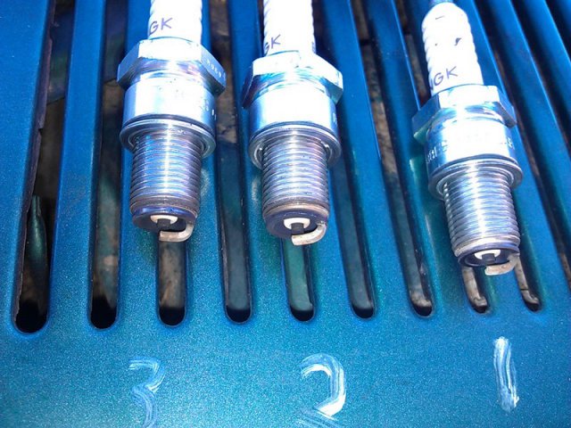

I agree. Sometimes I think I should have installed a toggle-switch for the W/B so I can just turn it off. Or like in my old Mercedes, just hid the display in the glovebox so you don't see it unless you need to. Plugs pictured below after about 10 hard miles. I think I am relatively close on jetting, fact is the car pulls hard to 7500 with no bogging or hesitation. Exception is the transition between progression and mains, but I am working on that. Recent weather change made my 140 mains feel a little fat, back to the 135s or wait for weather to go back. -

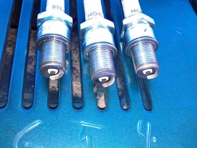

Overdue for an update. Motor is great. Pulls to 7500 and generally happy. These plugs below were fresh about 10 miles ago. Hammered the motor pretty good then pulled them and shot these pics. These are NGK B8ES which I manually gapped (lovingly) to .041". I am encouraged that there is no metal spray that I can see. Running a mix of 50/50 100LL Avgas and 91 pump gas. Pretty fat per the Wideband with a mid-11 idle and a low 12 AFR and below at WOT. I swear that my Wideband reads a bit low numerically. Maybe the lead is getting to it...? What happens when the lead in the 100LL finally ruins the sensor?

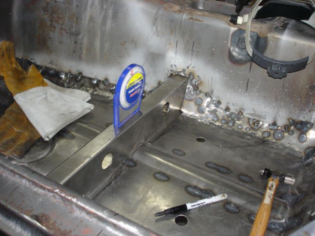

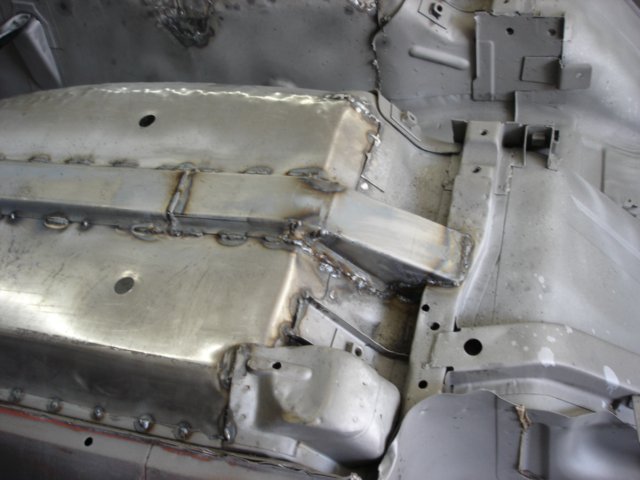

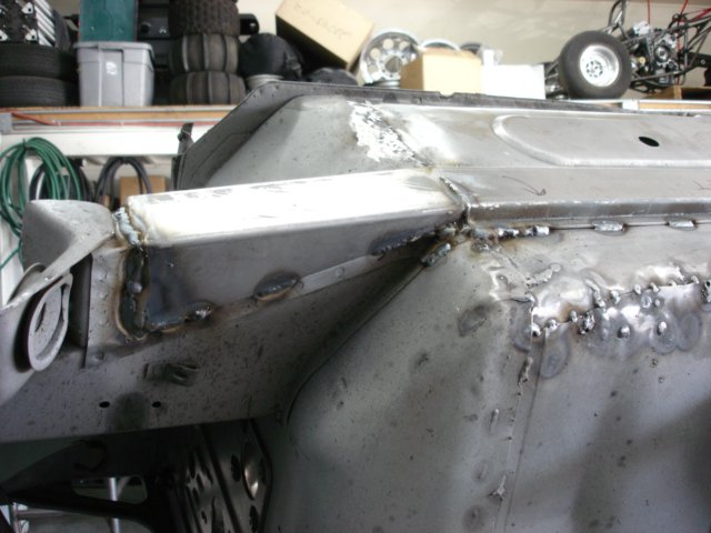

When I did my floorboards and rails and extensions on my 240 I bought them from some guy (in Canada?). Like a chooch I figured they would fit, but weren't even close. I think beating out your own will be perfect. I left my tranny cross member in place to help with alignment. Tack welded the entire frame while I was in there. Can't wait to see pictures.
