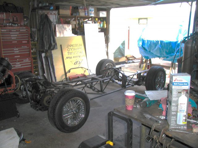

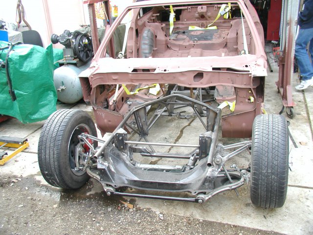

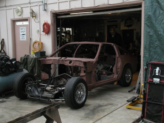

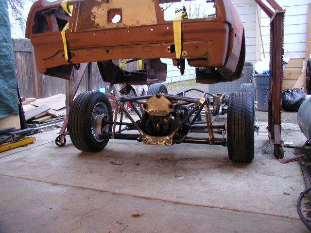

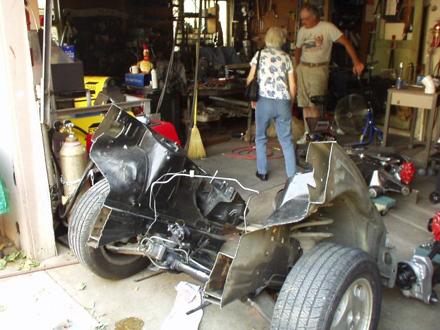

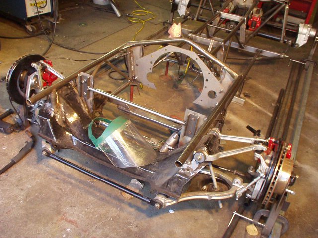

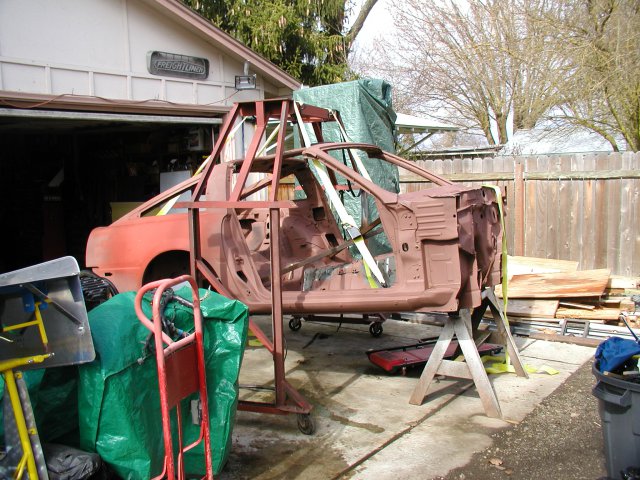

Looks like you're off to a good start. Even though I don't have any experience with Gen III engines, but any encouragment or faulty advise I can offer just let me know. Until I looked at your pictures, I had forgotten how much crap I have thrown away. Its really great to see someone doing a late model block in a Z31. Here is how I got around the clearance problem on my gen I 350. I'm still having some headaches with clearing the top of the magneto. 1. Front clip removal, or how I cleaned the engine bay. 2. Firewall and floor removal. or getting the crap off the underside of the car. 3. The chassis. 4. Like you said, Worth every penny 5. Home made engine plates solved my motor mount issues.

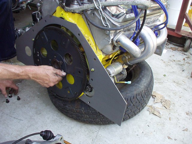

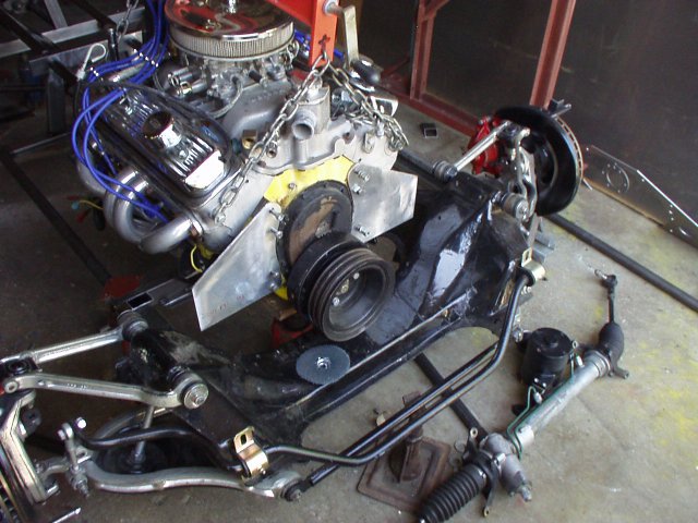

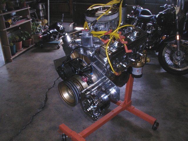

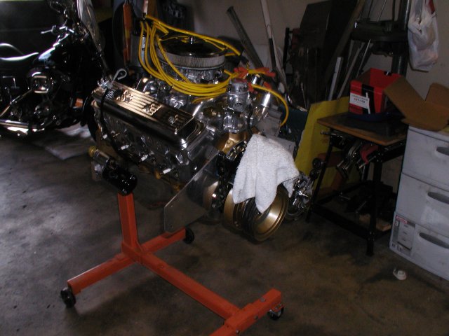

On the front of the engine in the Z31 I'm using an aluminium engine plate that I fabricated . In the rear is a steel torque plate of .090 mild steel. The only rubber mount is for support at the tail of the transmission. I did this mostly to stiffen the chassis, and transfer the torque load directly to the frame. (The same reason I am using inboard brakes in the rear.) The last pic is of the engine with the plates installed after I polished the heads and intake manifold. (Sorry about the pic quality, New camera.) Joe
