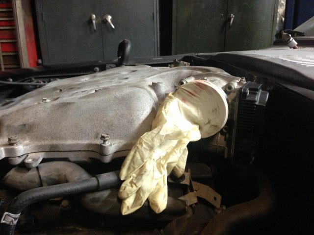

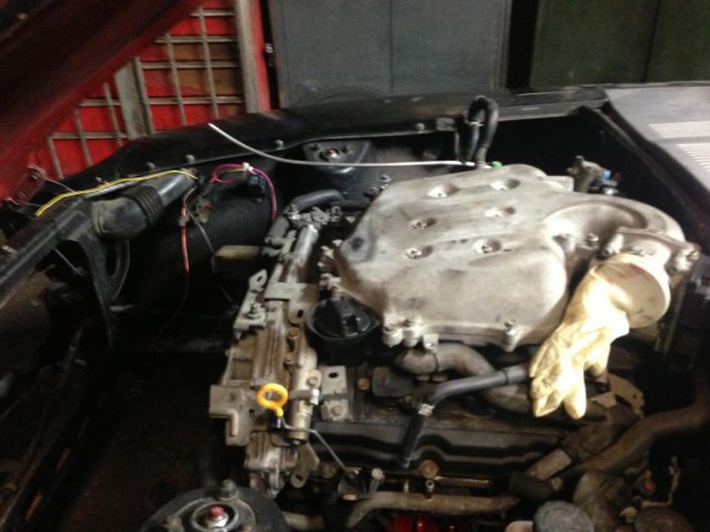

Yeah It definitely needs to go lower. Looking at my crossmember in an earlier post, I cut pretty much exactly the same amount of material out as Austin. looking at where his throttle body sits relative to the cowl, I need to go about an inch down and half an inch back. We'll see if there is enough wiggle in the mounts to get it down. And for the record, I wasn't talking about cutting the firewall, but the bracing on the inside of the hood.

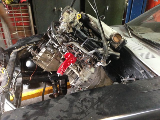

Progress! The engine and tank are in. Tank was pretty easy, mainly because I woke up late and EvilC did it for me... The engine proved to be a little tricky. The issue because of how tight the fit is between the firewall and crossmember, getting the engine to slot in is difficult. We ended up removing the upper intake plenum (after damaging it and the weatherstrip lip a bit) to get the engine to sit correctly. That said, I was hoping for a little input from others who have done the swap here. With the engine sitting about as low as I am comfortable with and as far back as I can it looks like I'll have to remove a pretty sizable section of the inner hood frame to clear the plenum. I am curious whether others have had the same issue or if I'm sitting higher than most. In any case, here are the pics!

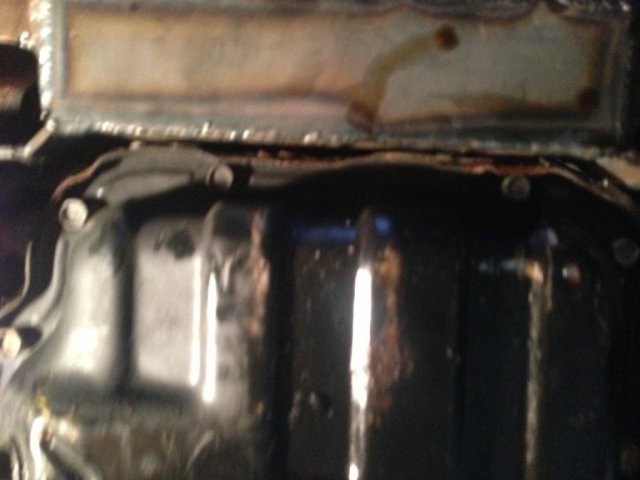

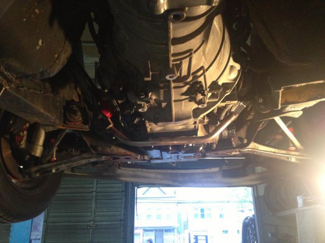

Another little update. Mounted my trimmed crossmember and removed the stock trans mounts, hood latch, fuel lines and stock fuel tank. This week I should be able to mount the new tank/pump and lines, and mock up the engine so I can mark where the engine crossmember needs to be welded in.

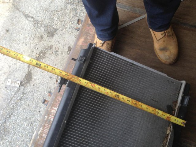

Ok so the radiator definitely doesn't fit, haha. It's narrow enough that it could have sit on top of the frame rails...if it were 4 inches shorter or V-mounted. Oh well. Will be ordering a new one soon. I'd be interested to hear the dimensions that people have run on here. I mounted the shortened shifter yesterday and it looks good. One interesting side effect of shortening the distance between the two U-joints that link the shifter to the trans is that the shifter rotates a bit more as moves through it's side to side travel than I'm used to, but it seems to work well.

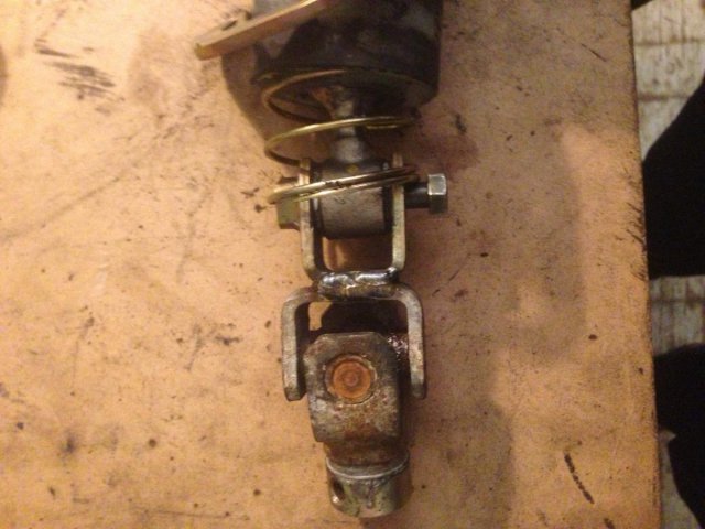

Shortened the shifter and coated the tank. May have clogged my pickup tube in the process so I will likely have to run another, but no big deal. This coating is pretty tough. My wiring harness should be coming shortly and my plenum spacer arrived. Hopefully I'll get the engine mounted this week. I think there is a chance that I'll be able to fit the stock 350z radiator and fans in the car. It'll be close as its wider than the stocker, but it's also shorter so it might be able to sit on top rather than between the frame rails. I'll test fit it this week.

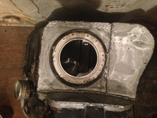

I posted these in my thread but I figured I should share them here too. Here's my progress on the pump swap. After welding it up I used a smoke machine to find the inevitable pinholes. I also ordered some tank sealer that I'm going to coat the inside of the tank with. My harness should be back next week so I will be able to test it out soon. -

Bought a cheap smoke machine to check for pinhole leaks in my tank. Found a few and sealed them up. Will go over the area with a sealant as a final measure but otherwise I should be good to go. I also sent out my wire harness to get cut down and reflashed. Finally have every piece for my r200/OBX/CV conversion except for the mustache bar. Getting there! I'm pulling the stock engine and trans this week to go to its new home.
