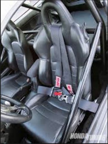

	  S30 semi-racing seats for big butt peopleDeathByNissan55 replied to DeathByNissan55's topic in Interior If it makes it any easier for people to find seats, I believe the seats I'm talking about are called "Touring Seats". Also I'm planning on running 5 or 6 point harness. So far the R100 is looking the most promising provided those brackets are done like Savage mentioned. I'd love to just use stock S2000 seats. Why can't you use harnesses with them? The picture makes it look like they'll work?
