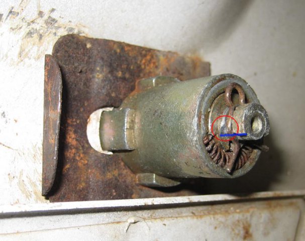

Haven't had much time to work on the Z, but I have been driving it around a little, which has been nice. I need to take it to a bodyshop. The passenger side front seems higher than the drivers side, and the fender and hood don't quite line up right. I think there must be some frame tweakage. I got my pass door pulled apart to look at the lock and window. The window was just off off a couple of its sliders... popped them back on and it rolls like silk (old dirty silk). The lock was apparently not keyed to the key that works the ignition and drivers door (come to find out the hatch is different too). Got the pass lock re-keyed but b/c the door didn't close properly for who knows how long (fixed both latches with some dremeling now) someone tried to force it and rounded off some of the cylinder material (see pic, blue line is where the original material should continue down to). I also FINALLY just broke down and bought a MOMO hub, and after it FINALLY came in I now have my steering wheel mounted. The Momo horn button binds up and sticks down for some reason, so it's out for now. I'll have the dremel take a look at a few areas, and that should clear it right up. So, I need to get my hatch re-keyed, fix the pass cylinder, and put the door back together, get the frame looked at, then start restoring and upgrading! -
