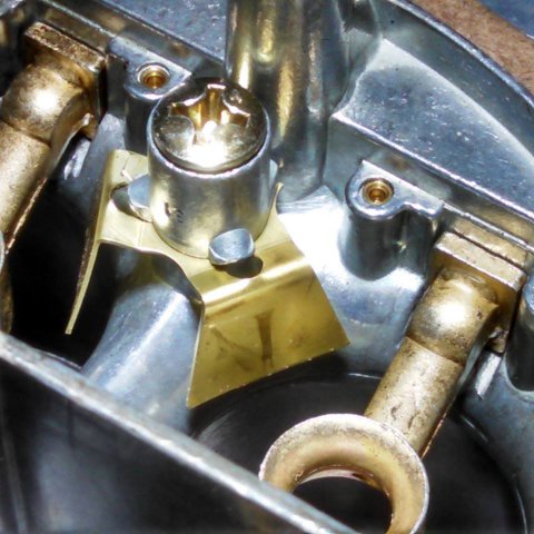

Well, this little Thompson Performance plate makes a difference. It's the first real attempt at improving the accelerator pump discharge for what seems like forever. I had to run a Reo (50cc/10 pump shots) pump through a standard #31 nozzle to get the balance I needed between volume and duration of fuel being injected into my Clifford manifold (large plenum volume). It ran well, with no stumble but the raw fuel droplets needed to broken up a bit better in my opinion to get a crisper throttle response. The fan effect seen in the video of fuel running off the plate makes a noticeable difference to the way the engine responds to the throttle and there is no fuel puddling which just sits in the manifold causing a soggy response and an overly rich condition afterwards. Get one of these plates and "viva la difference" Thompson Performance Holley.mp4

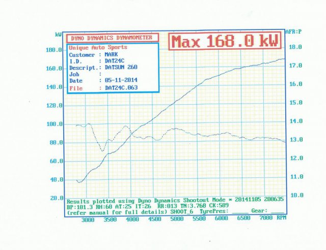

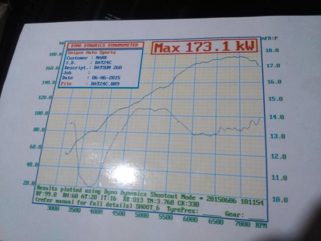

Very interesting. There is actually less power from 4500 to 6500 but where the power dived before just after 6.5K rpm, the new graph keeps pulling the numbers. Probably advancing the cam timing a little and maybe a little richer would pick that difference back up The ignition timing was the same for both runs, so nothing to be gained or lost there. Compression is up a smidge with the MLS gasket (1mm vs 1.2)
Yep, same dyno. That's an AFR measurement. Only power is displayed. Sorry for pointing that out Mr Dee I have the old dyno sheet too, will have a look and compare. thanks!

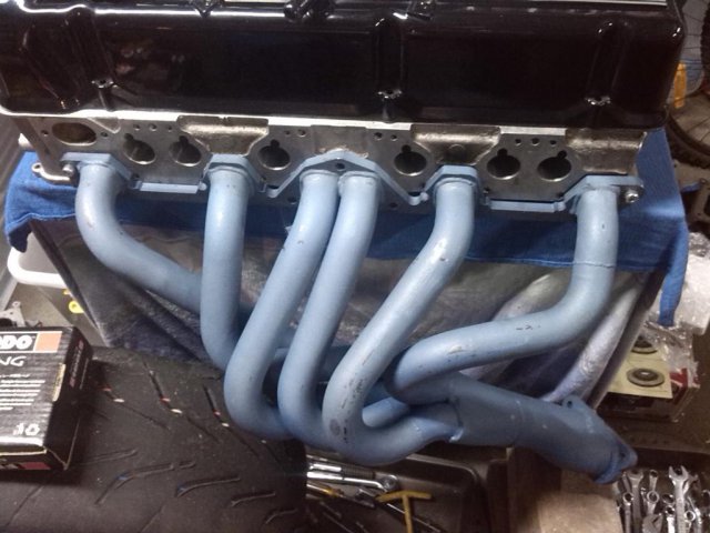

There's been some mods to the engine since this last post and there is a new dyno graph to go with it. Changes have been a Kameari 1mm MLS head gasket, twin idler gear setup and a Nismo balancer Wanted to use the Megasquirt ignition timing option but ended up just locking the advance in the ZX dizzy and timing it to 30 degrees. I had also planned on upgrading the headers to a beautiful tuned length item but there were time constraints and they're not on the engine.....yet! The headers on there are generic, locally produced non tuned length somethings with a section of 2.5 inch pipe at the end of the primaries. the rest of the exhaust is 3 inch though. I'm really very happy with the performance from this engine. Considering how many detail items are yet to be implemented, there's more power and torque in this combo yet.

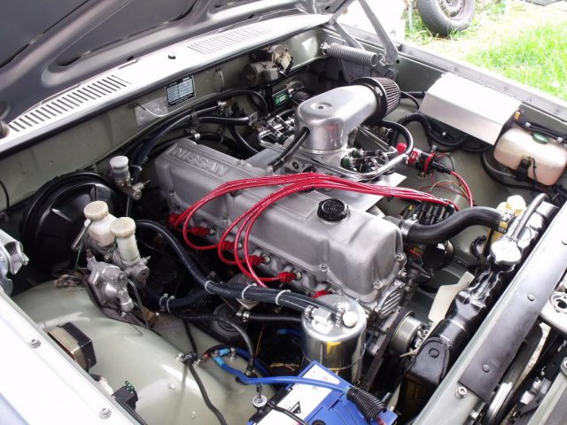

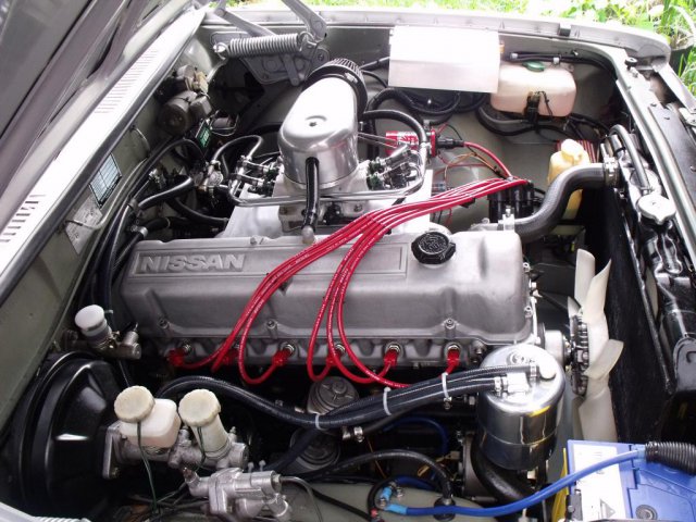

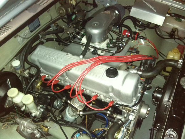

Taken yesterday, the big cam in this engine necessitated the addition of a vacuum tank. Can you spot it? -
Thanks Xnke...I'm totally stoked that the engine is producing this sort of power! Don't be confused. This engine belongs in my silver coupe, its the one that was going to be turbo'ed and had the P90 head on the N42 block with VG30DETT JE's, a 2850cc engine. Because I track this car, putting a turbo on was going to move me into a different class, so I decided to replace the P90 with a late model E88 off an L24E engine (R30 Skyline). I had my tuning shop "develop" the head to this point, swirl polished stainless L28 valves and a full CNC port and chamber re-work. The cam is a Wade 640A grind, 298 deg. Adv. duration, 595 lift at the valve. Timing events are Intake 44/74 and Exhaust 82/36 And the megasquirt is working very well, supporting this sort of performance. Cheers Mate!
