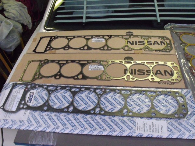

Nissan headgaskets.....the blue packaged ones are made in Oz buy a company called ACL for Nissan. The others "may" be directly from Japan but who knows? I know, I've got too many hg's, and that's not all of them
Too late tonight, but I'll get a photo or two of that universal "XX" Nissan HG on here tomorrow. Tony, good memory buddy! Cheers.
