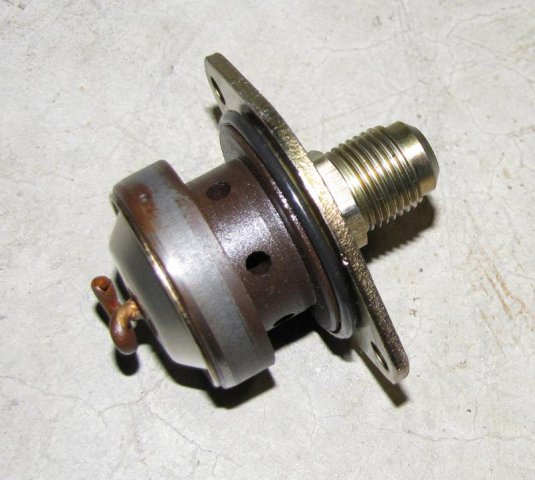

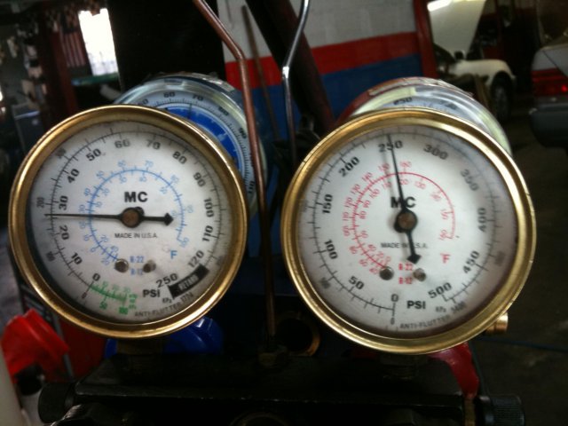

I just checked the screen and it was clear. Whew!! My expansion valve should be here tomorrow, just in time for 90deg F weather. Should be a good test.
Any thoughts on whether I should replace the o rings? They all visually look fine. I have not check Nissan or MSA yet but I did find a kit at Black Dragon. http://www.blackdragonauto.com/icatalog/z/full.aspx?Page=78
I ordered a used/replacement exp valve from Danny's Datsuns. Hopefully it will do the trick. I have not check the screen. Thank you for the advice. No. I didn't even know you could. I may try to do a flush before a recharge again. I pulled vacuum for several hours to remove all moisture. I did. I assumed there was residue oil in the system then added roughly 4oz. Thanks for the input.

Hi all, Earlier this summer I decided to rebuild the air conditioning in my 77 280Z. My desire was to stay with R12 and replace the compressor and receiver/drier. I found a brand new Nissan compressor from a ZX that was almost a bolt in except on a ZX the high and low side are swapped ont he compressor. Weird but easy to resolve with extended hoses. Next was my receiver/drier. For some reason the 77/78 280Z receiver/driers are different from all the other Z cars. I could not find a new, rebuilt or reman unit ANYWHERE. Ultimately I decided to have my rebuilt by a guy in Texas. It was a bit more cost but allowed me to use all my original copper tubing. I had the system charged up and initially got decent results. Vent was blowing at 39degF on an 85degF day. Here's the high and low pressure readings. I think the low side may be a bit too low. I took the car for a drive and the temp through the center vents would not go below 70degF. The R12 looked perfect in the sight glass . (no bubbles or low freon indicated). I also believe I have the correct amount of oil in the system. My guess is that my expansion valve is failing. I discharged the system and pulled out the expansion valve. It looked old but not necessarily bad. I'm not sure you can visually inspect an expansion valve. I found no debris or particulate that could clog or jam the valve. Here's a pic of the current expansion valve: Fortunately I was able to find a used replacement from Danny's Datsun in Roseburg Oregon. I will put the the replacement valve in and see if it makes a difference. If any of you are knowledgeable about Z car A/C please impart your wisdom. Thank you.
