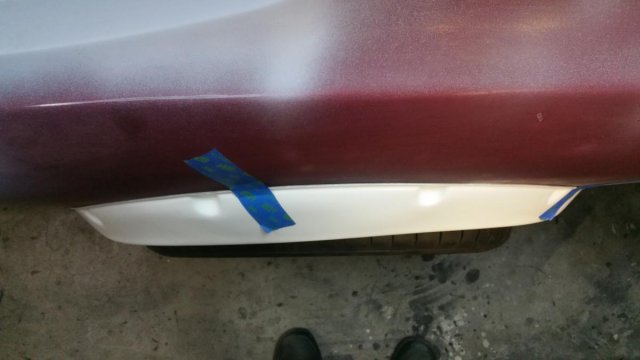

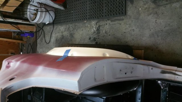

  14. Well, for what its worth, it looks like I'll need larger flares. I did get the Rota RKR 17x9.5 -20 wheels and mounted 275/40's. Tires are Sumitomo HTZR. With the Marugen Shoukai ZG flares, the tires are about 3/4" outside the flare with the adjustable control arms all the way in. Not sure why this combo seems to work for some but not me. I could probably dial my camber way in, but I'm not really fan of that look on my own cars. So, it appears as though my next best yhing will be to get a set of jpngarage Wide ZG's. Any feedback on fitment would be welcome. Anybody know of others making wide ZG's? jpngarage flares seem to get mixed reviews.
