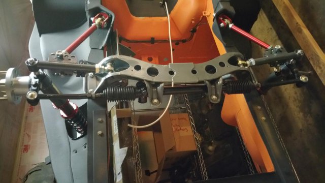

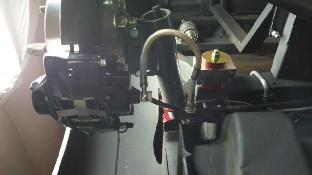

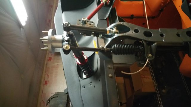

And some progress over the last week or so, and some lack thereof as well. Finished up my steering rack. I bought a used one off a member here for cheap, and it felt pretty tight. So I cleaned it, repainted it, got some new tie rod ends and boots, new poly bushings, new grease and installed. Finished up the rear brake lines. Seems the threads were messed up on the original fittings. I couldn't get them to thread into the new adaptors. Not sure if it was the threads being bad, or that the original fittings were threaded all the way down to the end and the adapter fittings looked like they wouldn't allow that. So, I decided to just make new lines with new fittings. I got enough line and fittings to redo everything, which is my plan. I was going to need to rework the front lines anyway to work with the new Wilwood master cylinder and proportioning valve/splitter. Soooo, that'll be fun. And I finally bought and received the rotors for the front brakes I was going to try do. I really want to use the Z32 calipers I rebuilt. I was going to use Honda Odyssey rotors. They would need to have the center hole enlarged, and the pattern redrilled. After calling many machine shops in my area, nobody will take on this job. So, I'm rethinking the rotor choice. Now looking at Wilwood rotors and rotor adapters. Looks like the 5 lug TTT hubs I picked up have the same rotor bolt pattern as the Wilwood adapters. This looks like a pretty promising solution, and it'll be nice to have rotors that are relatively off the shelf. -

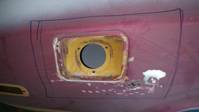

Thanks for the ideas on the filler. I do have the original Camaro filler neck, it came with the tank. But I have body rot around the filler area and have thus far struck out thus far on finding that body cut. I have taken that inner part off, and it could be saved if I had to, but the body has holes in it, at the curve and I don't think I can replicate it. If I can't find that body area in decent shape, I may use one of the these Hagan fuel doors. they have them in different shapes too, might be kinda fun to go with a tear drop shape, since the rectangular wouldn't match anyway. But I'm still holding out hope to find someone parting out a 240z with that area not totally rusted to crap. I've got a long ways to go before I'll be seriously into the body work. If anybody has used or seen one of the Hagan fuel filler assemblies, I'd sure like to hear about it. The hinge looks like a weak link. I've also thought about going to the junkyard with a cordless grinder and cutting out a rectangular filler on one of many cars out there with similar sized doors. For about a month I was driving around looking at every cars gas doors thinking I could just cut that one off, or maybe that one... -

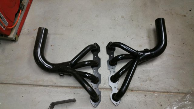

Wish the CX long tubes would work with the JCI mounts, but I think I've read that people say they won't. Doesn't look likely from your pictures but maybe... Thoese don't look like the JCI headers. JCI headers are 1 5/8" and look quite different than those. Maybe those are the JTR headers? Here is a pic of the JCI headers I got. I didnt buy these from JCI, I bought them from a HybridZ member, but was told they were JCI.

I can't imagine doing so much of what I've done while on my back under the car. Other big advantage is the car takes up much less room in my tiny garage when on its side. Danks And still having a lot of fun. Decided to replace all of the brake lines, and even enjoying that. -
