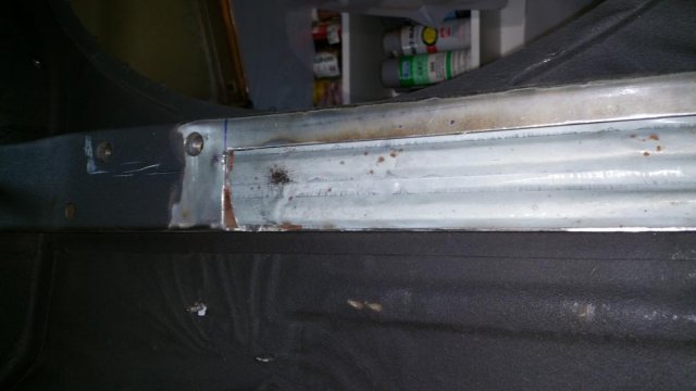

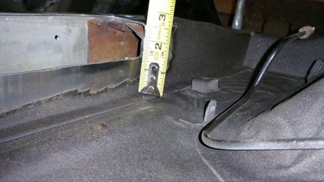

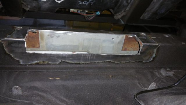

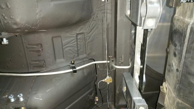

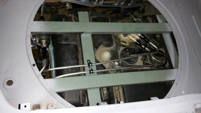

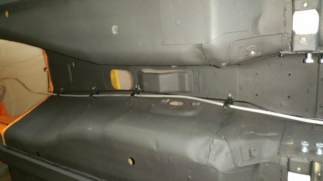

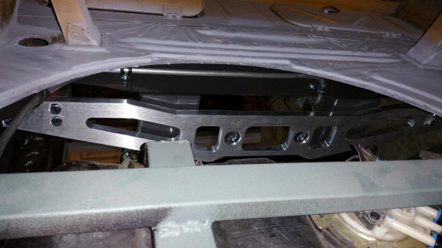

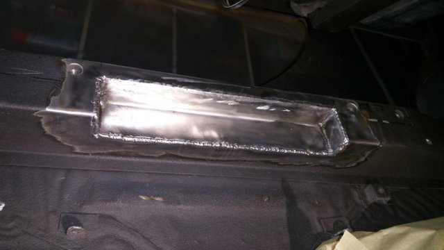

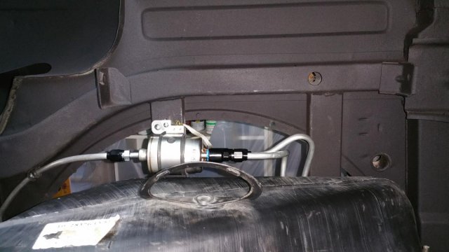

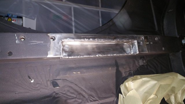

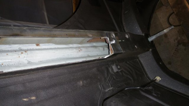

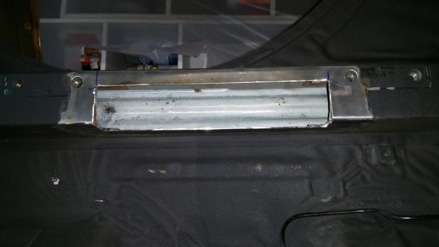

Got some more stuff done. Finished the undercoating with the 3M rattle can stuff. Man, that stuff off gasses pretty bad. Way worse than painting did. I had to install a small ventilation fan in the garage to the outside, to avoid having to sleep in the dog house, as it was still putting off a smell days later. Got the gas tank in and plumbed. Supply and return to the corvette style filter, and supply into the engine bay. I decided to run the same oath the original line went, since I was using aluminum and it seems pretty well protected up in there. If I ever have a problem, I'll just abandon it and run a stainless line along the frame rail. Started bolting in the rear suspension, only to find out that the TTT R230 install requires a large notch to the cross frame. So out came the fuel line, which will need to be redone and rerouted so it doesn't go between the drop mounts like it did originally. Off came the rear suspension, out came some of the brake lines, and out came the grinder for some cutting action. Took less time than I was expecting it to take, and now back to installing new parts, and restoring old parts. Won't be able to work on the car this weekend, going to a vintage trailer rally -

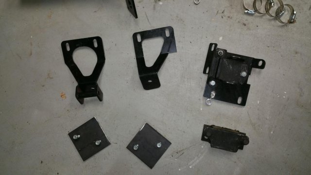

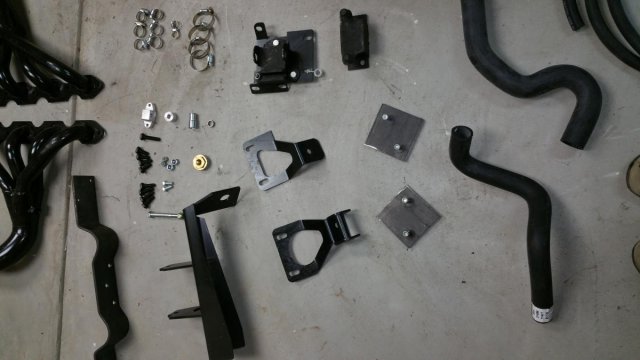

More progress. Painted the engine bay today. Been working on it for a while, but it's also hard for me to get the large block of time required for actual spaying. Wrangled 4 hours a couple weeks back, and 4 more hours today. I went with a Chrysler color called Orange Crush, and a flat clear. Had a couple sags in the clear, on the shock towers, which I will be able to isolate and redo, but it will go pretty quick. Anyway now I just have to finish undercoating the car, something I can do in 1 hour spurts, and then get to assembling this big pile of parts I have accumulated. I've got all the parts for the T3 R230 rear end swap sitting on the shelf, along with new T3 rear control arms. All the new fuel lines to run, brake lines to put back in, coilovers, and probably a few more parts I'm not thinking of. -
