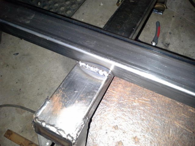

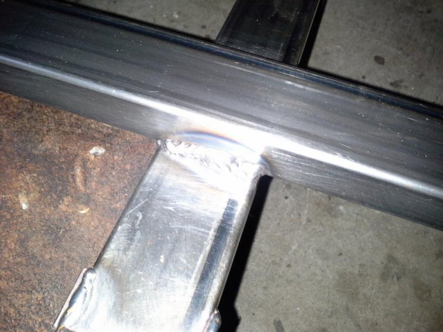

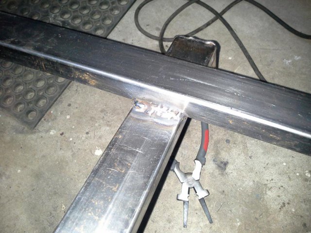

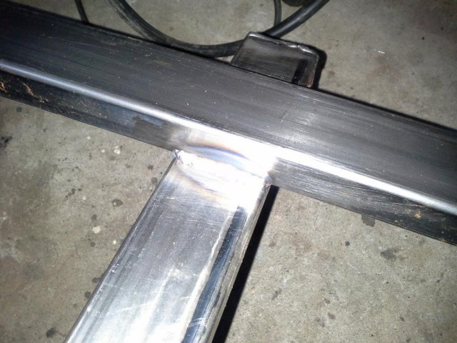

Thanks guys, I'll try these tips. I usually get the gun in as close as possible with still being able to see around it. It's tough getting good body position but I'll try to be more patient and reset the work each time. Never heard of cutting it every time, but easy enough to do. I try have the stick out be really short, then pull the trigger and let it feed in to start the arc. I figure this gives it a little time to build up a small gas shield. I'm sure I need to slow down and weld more scrap together for practice too.
Wondering if someone can help a little bit. I'm getting very inconsistent welds. All 4 of these were done at the same time, same material, same settings, same prep, same body position, and I thought same hand speed. Yet I get 2 welds that look okay to me, and 2 that look like turds layed on top. This is with a Hobart Handler 125 with a CO2/Argon mix tank. This particular material is 1/16" x 1"x2" tubing. When I'm making a pass on the bad welds, there is popping, like the wire pops and breaks back and I have to wait for it to feed back in. It often seems to help if I kind of "push in" when this is happening, and then it can start a good puddle. I'm guessing it has to do with wire feed speed and hand speed, but not sure which is too slow. Any help is appreciated. I'd sure like get my consistency up before I start welding in my camber plates
