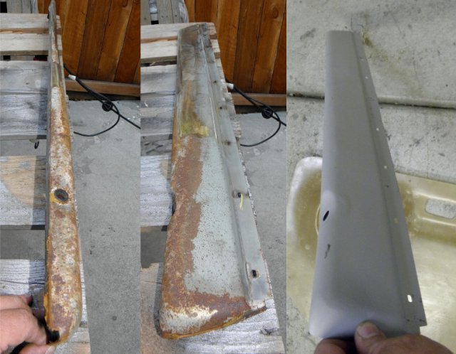

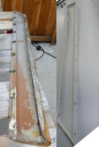

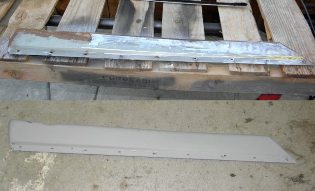

  5. Here's what I used. http://www.acehardware.com/product/index.jsp?productId=1289220 I removed the trim piece and all its staples when I stripped the metal top piece. I scraped the fuzz from the trim, then use pop rivets to attach it back to the primed metal top piece. The seal covers the rivets. The pile seal has an adhesive backing that stuck well to the trim, but it's been a few months the edges are peeling. I'm going to try a little contact cement. The pile seal is gray instead of black, and it's a little narrower than the original, but it looks really good installed.

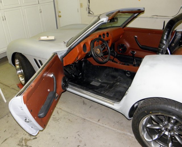

  10. Seats are installed. With the new foam and upholstery, the driving position is higher. The steering wheel and shift lever are now uncomfortably positioned. But at least now I can work from the actual sitting position in order to get the ergonomics correct.

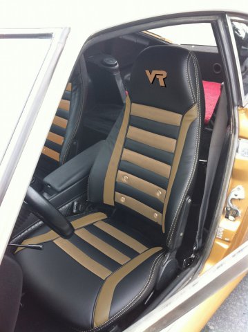

  12. Well, it's not perfect, but I'm happy with my first attempt at covering the seats. It took me most of the day to install the butt warmers and seat covers. It's a cold rainy day in Norcal, so my cheap heat gun came in real handy when it came time to stretch the synthetic leather. I wasn't able to get all the wrinkles out, but I'm pleased with the overall appearance.

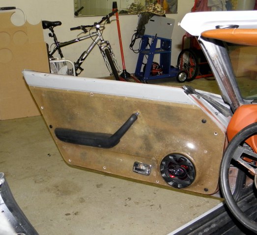

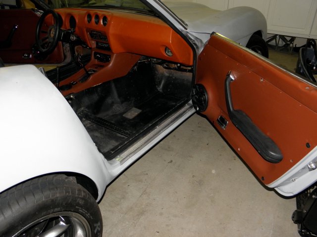

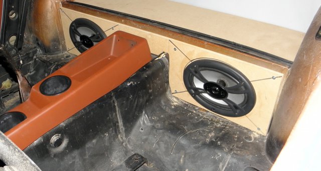

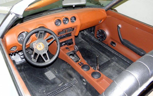

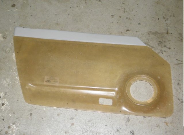

  15. A little interior work while I wait for the new seat covers. 6X9 speakers mounted behind seats. A little primer on the new door panels gives the interior a more finished look.

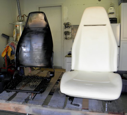

  16. New seat foams arrived yesterday. Still two weeks before the new skins and butt warmers get here. In the meantime, I'll be looking for the clear acetate material to cut new protective pieces that go between the skins and seat mechanisms.

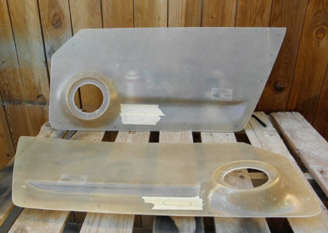

  17. Pete, it was great meeting you on Saturday. Love the panels. Drivers side fits perfectly. Moving on to the passenger side later this week. Playing with some upholstery designs to match the seats. BTW, those mounting pins turned out to be onetime usage. Removing the panel after the first test fitting pretty much stripped them. Looking for alternatives. Continue best wishes for a speedy recovery. Thanks again. Wes

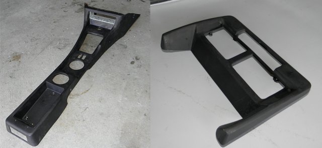

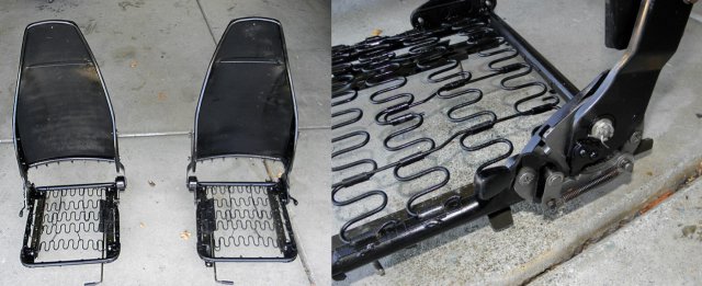

  18. There's actual progress to report on several fronts. 1. I simplified the mods to the center console and heater facia. The way I originally moved the stereo forward, to accommodate its iPod dock, covered up the emergency flasher switch, eliminated space for other switches (most likely for the seat warmers) and gave the whole console a bulky look. Tacky!!! As for the heater facia, I filled in the seat belt warning light and the corresponding empty box on the opposite side of the map light, and smoothed out all the textured surfaces in preparation for the hydro-printing process. Still a lot of sanding to be done. 2. I stripped the seats to their skeletons, disposing of the ripped vinyl upholstery and broken-down smelly foam underneath. Disassembly was not an easy task! I had to heat at least two bolts on each seat to break them loose. Where ever there was adhesive, there was rust. And where ever there were moving parts, I found thick half dried grease. What a mess. The nooks, crannies and springs got sandblasted... the seat-back shells got hit with the grinder... the bolts and reclining mechanism pieces went into the vibratory cleaner for a couple days... then, after a coat of rust treatment, everything got a couple coats of black paint and reassembled. They look good and operate perfectly. New foams, butt warmers and custom seat covers (still haven't decided on the color combo) to be ordered next week... barring unforeseen circumstances. 3. Picked up door panels with speaker pods from Pete today. Nice, quality pieces. So, as soon as I got home, I went to work on the drivers side panel. The metal top piece was a mess. Just like the seats, there was rust everywhere there was glue. No problem for my trusty grinder and a flappy disk. More rust treatment and some primer later... ...and behold a solid, like new base for a custom interior. 4. And lastly, I've begun the process of title/registration with Ca. DMV. I figured I'd get the ball rolling and have everything in order when the new year rolls around so I can get one of the 500 Certificates of Sequence issued each year for special built vehicles. If you don't know, a Certificate of Sequence (COS) allows the vehicle owner the choice to title a "special built vehicle" as the year of the engine or the year that the body most represents. Thus exempting it from the current years smog requirement. I know from other owners of replica cars, that DMV usually runs out of COS's in the first few days of the year. I made an appointment, gathered all my receipts and required forms and marched into DMV feeling pretty good. That feeling didn't last long. The poor guy who helped me had never done this procedure before. He spent a lot of time referring to a DMV procedure manual and consulting a supervisor. Eventually he informed me that there was good news... and bad news. The good news is that there are still COS's available for 2012. It seems that there have been changes in the law concerning the way custom shops go about registering their creations now. They no longer need COS's, leaving them for home builders like me. The bad news is that I've lost bills of sale for a couple of the major components used in my project. Since I can't prove ownership of these parts, I'll need to get a motor vehicle bond in order to title the car. The only word that flashed into my head was "EXPENSIVE"!!!! I left DMV pretty depressed. A few hours later I began researching bonds on the internet. As it turns out, a motor vehicle title bond is easy to get and not expensive at all, at least not for the fair market value of my car. And it actually simplifies the title process by substituting for all those receipts. With the mystery that is the titling/registering procedure fairly clear now, I'm feeling a lot better. I don't have to rush toward a deadline of January.

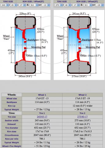

  20. Back spacing for both wheels is 4.5 in. That makes the front offset -13mm and the back -19mm. This pic has all the dimensions and compares both wheels and tires. And I used a 2" spacer on the rear and a 1" spacer up front. Needed the rear spacer to fill the fender well. I needed the front spacer only because the center cap would not snap on over the Datsun dust cap.

  22. I'm thinking of using this hydro printing technique to finish the center console and heater facia in Burlwood or carbon fiber. Has anyone here used/had success with this?
