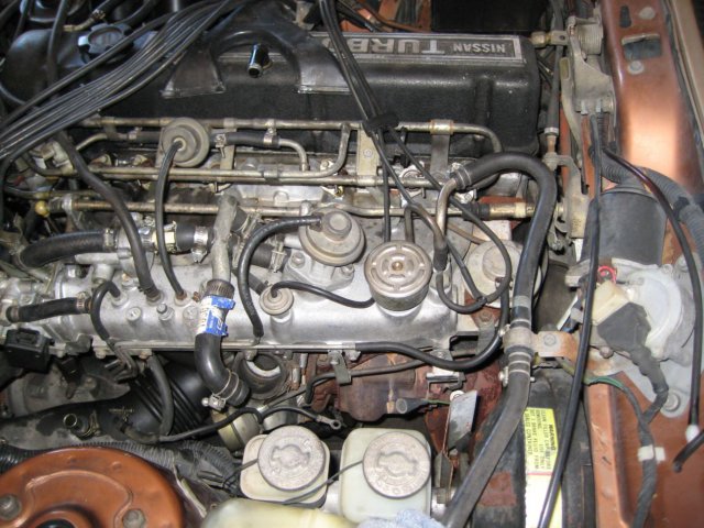

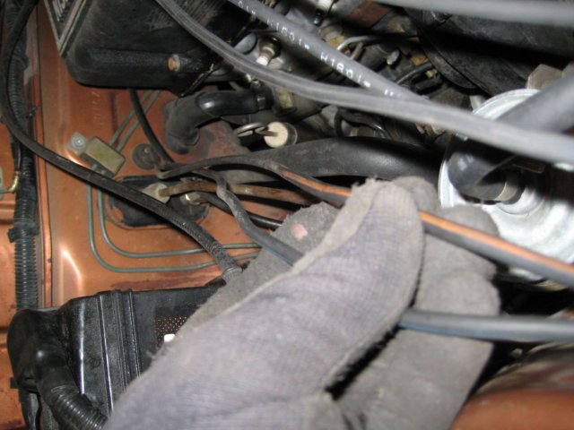

#3 - That big hose shouldn't be there... Only two are needed, one inlet to the heater core, one outlet. Someone did something funky under the dash?? There's the aforementioned valve connected to one side of the core by a short piece of hose (and it's operated by the temperature control cable NOT a vacuum solenoid like I said above...). One of the water hoses connects to that valve, the other directly to the core. But still, there should only be 2 water lines under there...
Well, there's a few extra things on the turbo intake, but the basic parts and vacuum stuff is generally the same on all of them. The little valve on your last picture is for the A/C system. It increases the idle speed if the A/C is running. The missing line should go to your Idle Air Controller...

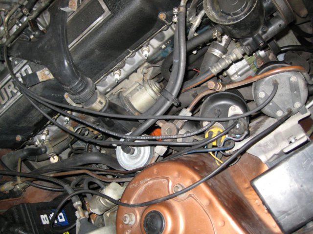

Here's a pic or two of an original '81 280ZXT with the J-pipe and wiring harness out of the way. Hope it helps some... All of this should be in the FSM.
