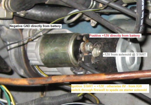

No power to starter/Ground issue?
cgsheen replied to Med Center Z's topic in Trouble Shooting / General Engine
You should replace the Receiver/Dryer (Accumulator - little bottle on the passenger side fender well). It's the main system "filter". Before you reinstalled the condenser and engine bay piping you probably should have run some A/C system cleaner through that stuff as a precaution. The early Z's don't use many o-rings. The tubing connections should be flare fittings and the o-rings in the system will be inside the compressor and inside the expansion valve - you don't want to mess with those as a general rule. It's helpful to reassemble flare connections by using a little A/C oil on each side of the flare itself. The oil you use should be the oil that's compatible with the type of refrigerant you'll be using. Sounds like you're converting to R134a? If so, you should have dumped as much of the mineral oil out of the compressor as you could, and replaced what came out with Ester Oil or PAG.

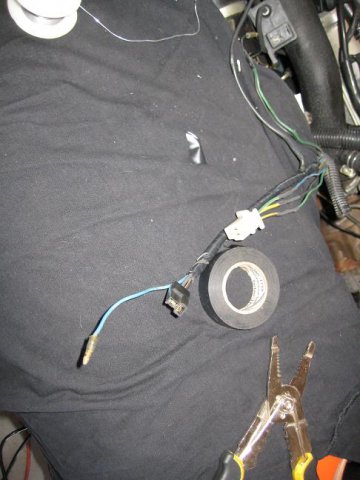

The Black/white wire should have +12V at IGN ON - it supplies power to both the Ignitor and Coil. The Yellow is the "trigger" signal from the ECU and shouldn't be showing battery voltage ever, IIRC... The ECU controls the firing of the coil. The "Ignitor" is a transistor (ignition unit) that amplifies the signal from the ECU to a value that will cause the coil to fire. Re-check that particular wiring to the ECU. If you haven't read this by now: Most common problem with these old EFI and ECCS systems is wiring, connections, and connectors! They corrode over the years. Check and clean them all - then do it again... Oh... The Ignitor is a transistorized "solid state" component (not a relay or anything) - I've never known one to "click". You don't have any cracks in the coil do you? You CAN'T use an N/A distributor on a turbo engine. They are two DIFFERENT animals. On the Turbo engine, the distributor holds the Crank Angle Sensor (optical wheel built in). The ECU uses the CAS signal to know when to fire the injectors and when to fire the coil. The 4 wires from the turbo dizzy need to be properly connected to the ECU. ALL the methods of testing the wiring and components are spelled out in the FSM. Pretty easy to do if you follow the testing and troubleshooting guide in the FSM.

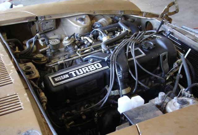

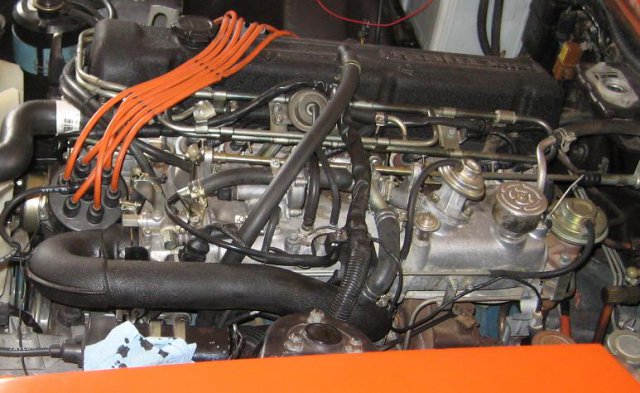

Here's the only thing I was refering to (which is the only thing you can really tell from your pics) - Pics of bone-stock L28ET Intake Manifold, J-pipe. Yours is obviously altered - not saying that's necessarily bad - just that you may need to understand the differences...
That engine is NOT a stock L28ET. So, ya, it kind of looks like a "frankenstein"... You may have to see what the stock engine really looks like to understand the differences.
