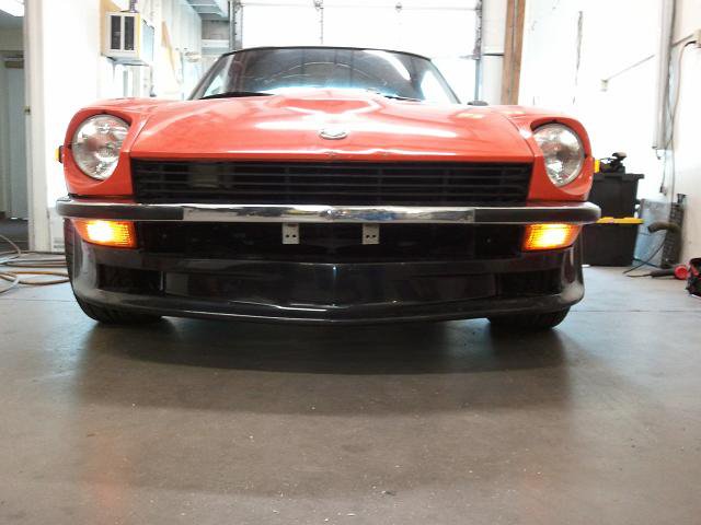

  7. Mine's from MSA, I just used the stock front valence mount points: 2 bolts in the fender, 2 (or 3 if you like - I did) bolts in the headlight bucket. We mounted my son's on his '76 the same way.

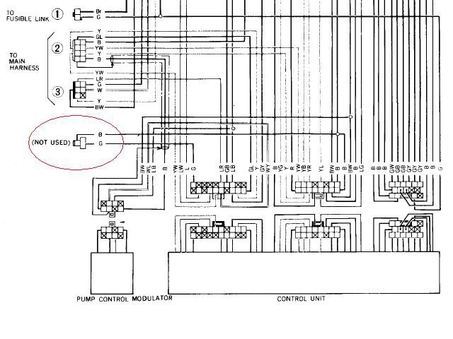

  17. There is no "switched ground" from the ECU. There are 4 wires to the CAS: red = +12V (battery voltage through EFI relay), black = GND (to intake manifold with others), white & green = 1 degree & 120 degree signal to ECU.
  18. Dude... Do you have the 1981 280ZX Factory Service Manual? Do you have the (1981 280ZX) Turbo Supplement? The wiring diagram is right there. A. The C.A.S. gets NO "ground signal" from the ECU. It's just grounded to the engine along with a bunch of other grounds - including some ground connections to the ECU. (The ground for the CHTS, Air Regulator, & etc. are all connected to this particular ground as is most of the sensor wire shielding...) - Just make sure the C.A.S. has a good GROUND. - Check it has +12V (battery voltage) at IGN ON (power to the CAS comes from the EFI Relay which powers the ECU at pin 35 and several other sensors & devices) - CAS wiring is: Red +12V, Black GND, White & Green are the 1 degree / 120 degree signal to the ECU (sorry, don't remember which is which) B. NORMAL operation for the ECU: Green LED comes ON (stays ON) at IGN ON. Green LED goes OFF at engine crack or engine start. Green DOES NOT COME ON AGAIN until ECU tries to go into "closed loop" mode. In closed loop the ECU is monitoring the O2 sensor and constantly adjusting the injectors to ride the edge of "just Rich" and "just Lean". The LED ON at this point indicates the engine is running rich. The ECU does not even try closed loop mode until the CHTS reaches a certain temp - several minutes after engine start. - I don't believe the ECU LED will go OFF if the ECU isn't getting a CAS signal. (disconnect your CAS where it plugs into the ECCS harness (by the thermostat housing), crank the engine, see if it stays lit or goes out upon cranking) - check your spark. There will be NO SPARK if the CAS isn't working. The ECU creates (sends) the spark signal to the Ignitor/Coil. It can't (won't) if it's not getting a CAS signal. C. You CAN use an '82-'83 ECU with an '81 harness. You have to remove the dropping resistor pack AND REWIRE the connector OTHERWISE the injectors have NO power. (the resistor pack has one +12V "feed" that runs to 6 different resistors then to each injector. 7 wires. Hook them all together.) The '81 Turbo Supplement says the injectors are powered through the EFI relay at IGN ON. In the '82-'83 they are powered constantly from the battery through a fusable link. D. ALL this information is in the FSM (and several places in these Forums). E. There is a COMPLETE TROUBLESHOOTING GUIDE in the FSM. F. It's easy to follow. G. It you follow the guide, you'll find EXACTLY why your engine won't start (without having to replace parts that don't need to be replaced). I have a working 1981 280ZXT ECU. Just removed from my running L28ET a couple of months ago when I swapped to the M30 ECU. (Heck, I have the whole thing - ECU, Harness, AFM, Coil/Ignitor (no CAS)) I also have a 1983 280ZXT ECU. PM me if you want to spend money on parts...
