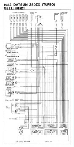

There's an "FAQ" on "turbo alternator upgrade" or just "alternator upgrade". Take a look at that. (swapping an L28ET and using it's alternator in your otherwise stock 280Z, is the same as doing an alternator upgrade on your L28E...) Yup. In the 280ZXT, the ECU controls the fuel pump through the fuel pump relay. You need to understand how your stock fuel pump relay is "switched on" so you can change it to be controlled by your new ECU. As for the coil/ignitor: The Blue wire goes to the Tach through the resistor under the dash. Mine was behind the glove box. The resistor is big and square-ish and sticks out of the harness with 2 wires attached. The Yellow/White goes to the ECU through one of those white connectors near the end of the ECU (ECCS) harness. Important, because that's what tells the ignitor to fire. The Black/White ties to a Black/White on the ignition switch. Also important. In the 280ZXT, Power for the injectors and ECU is supplied from the battery, through that black box with the fusable links, to both a brown and a green wire ("connector #1" in the wiring diagrams). that run accross the firewall and into the ECU harness. I'll try to find the wiring diagrams you need most and post them... It's true this type of post is not meant for this particular Forum - should be just about turbochargers themselves or related to turbochargers... People make mistakes - the Admins will move it or kill it if it needs to be done. We'll start again in a more appropriate place if we have to. If an Admin (or established member) scolds you, simply apologize and be more careful in the future. (Don't know how much experience you have with Forums, sometimes it's best "not to feed the trolls"...)

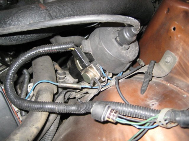

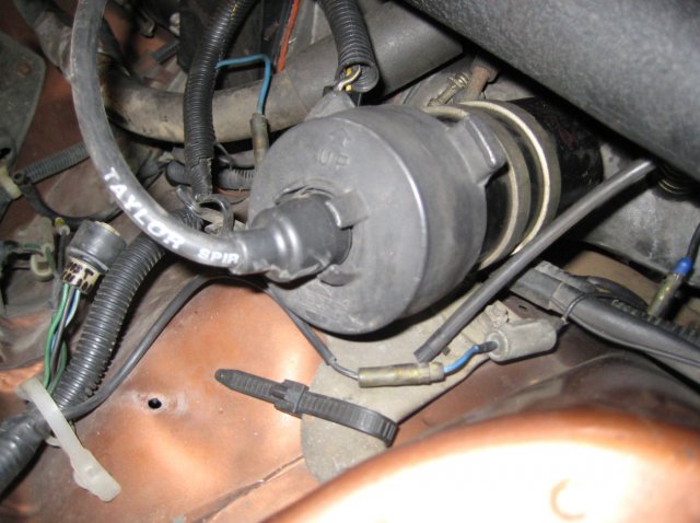

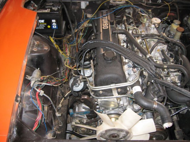

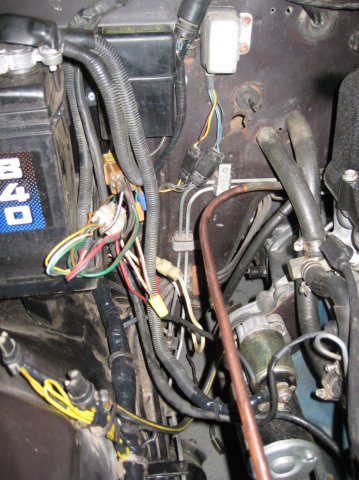

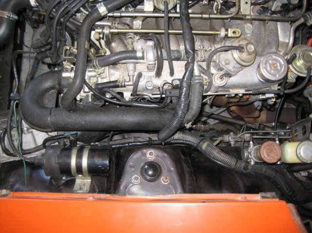

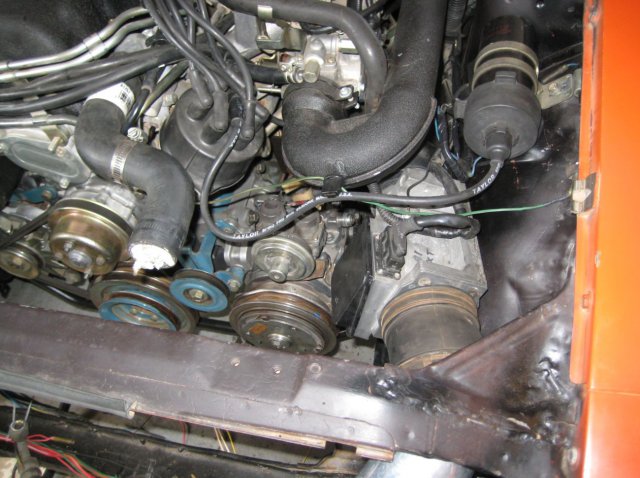

These are pics of how the coil sits in an '81 280ZXT. The harness runs through the fender back to the left side cabin on the 280ZX. The Stock ECU mounts under the dash beside your left foot. That 3-wire connector in your ign harness picture above is a connector for the Boost Sensor. Here's how I ran the wiring in my 260: You can also kind of see how I mounted the AFM... Yup, it's upside down in my car. We mounted the AFM in my son's '76 280 mostly rightside up - it's harder to fit. We did his 4 years ago, mine 2 years ago. Doesn't seem to make enough difference to care... Here's an early shot of how the coil and AFM went in my 260 swap: Don't let this deter you, I changed a LOT of the wiring in my car while I was doing the swap. My 260 was never set up for EFI, and I knew I'd be using the 280ZXT Alternator. I eliminated my external voltage regulator and the shunt that drives the ammeter guage during the re-wire and installed a volt meter. Plus I eliminated the original coil wiring since I used the harness from the donor... I used a LOT of the wiring from my '81 280ZXT donor car - including the Fusable Link box:
