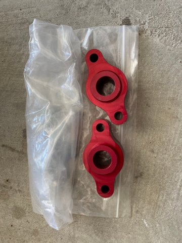

Finally getting rid of parts that I bought, then changed my mind on, then replaced with something similar. 🙄 Price does not include shipping. All these parts (except the axles) were mounted but have zero mileage on them so here goes: 1. Z-therapy rebuilt SU's. SOLD 2. E-brake bracket, spot calipers, and cable for Arizona Zcar wilwood rear brakes from first WOZA group buy. Including new Wilwood prop valve. $350 Backet was trimmed so you don't need to pull the hub to get them on/off. Picture just for ref of it mounted, only items listed are for sale. 3. Arizona Z Car rear caliper bracket $100 Lovingly modded by JohnC 😄 4. Techno Toy Tuning Bump Spacers SOLD These were never mounted 5. Stock 300zx CV axle shafts SOLD 2. 3. 4.

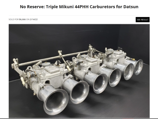

People are crazy. I think BAT is a major reason why parts are hard to come by these days.
