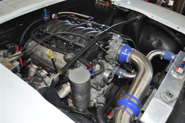

  4. The UD balancer will slow the water pump down but it won't be slow enough to effect the coolant system. Also stops cavitation at high rpm. I don't think millions of LS owners would run them if they were crap. I'm interested about the PTV clearance issue you had with that cam. Was the cam advanced? Or was the cylinder head shaved for a higher compression? I'm thinking more of a 228-230 cam now, with less than 0.600 lift, something that retains standard lifters and pulls from 2500-6500ish.
  5. Hi, I'm looking at upgrading the cam in my standard 2001' LS1 (in my 240Z). I dont mind going something big as this is just my weekend car and not a daily driver. Maybe 232/234 or 238/240 etc. Apart from the cam this engine will have ported and polished 241 heads with about 20th shaved, 25% UD balancer, ARP head, cam, balancer and bolts, LS6 injectors, ported factory throttle body, LS6 manifold. My questions to the LS gurus are a follows: What size cam or rpm limit can still have the standard lifters? At what size cam do you require solid lifters? At what point does the LS1/6 run into piston to valve clearance issues? I know I will need new pushrods but I will measure the gap once the heads are installed, I already have PAC1218 springs. I'm sure I will have more Q's but that its for now. Thanks in advance.

  17. LS1 injectors are supposed to run at 60psi but if you're blowing hoses at 80psi then there is a weak point there (hose wise) that I would be fixing. I would take a punt here and say you've got a vacuum hose hooked up to the reg when you shouldnt have. NA LS1's run a constant fuel pressure where as other models run variable. Most regs have a vacuum port to hook your manifold pressure up to but in your case you dont need it.
