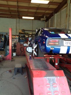

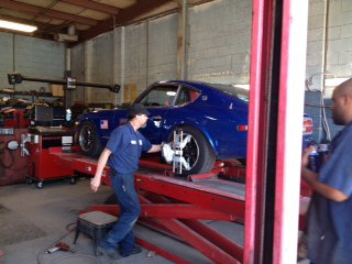

Trip to alignment shop was fun but as usual I can't do anything on the first try. The technician used a 4 wheel laser system - it was cool. But my goof up on my rear LCAs limited me to .75 neg camber. The passenger side LCAS had to be shortened and the driver side lengthened - seems my car is pretty warped! Will be going back next week-I went thu the machines report and found that the mechanic read the machine wrong and really over did it when he figured caster for the crown of the road- he adjusted one side to 4 and the other to 5.5 instead of 4.5. Car drives straight with the steering wheel cocked just a bit to the right. Toe in is 1/8 front and back. Time to do chassis mods for exhaust clearance. -
