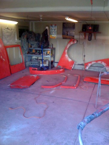

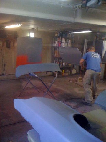

  4. On the trailer going to paint shop All the parts sealed. Base coat applied to parts Clear coat applied. Cant believe i may have a car ready to put back together in a month or so !!!!!

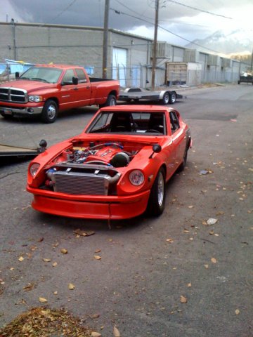

  5. As compared to my car before.

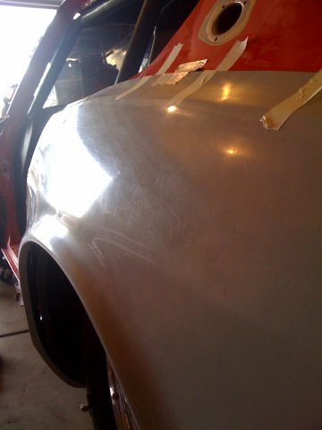

  7. Got the other side stripped down. i don't know what kind of paint was on that 1/4but it basically melted and gummed up the sandpaper. so i just zip stripped it.

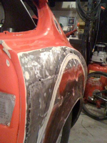

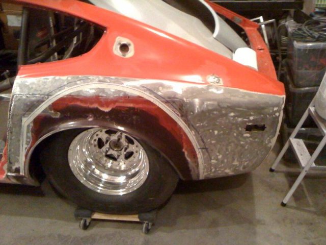

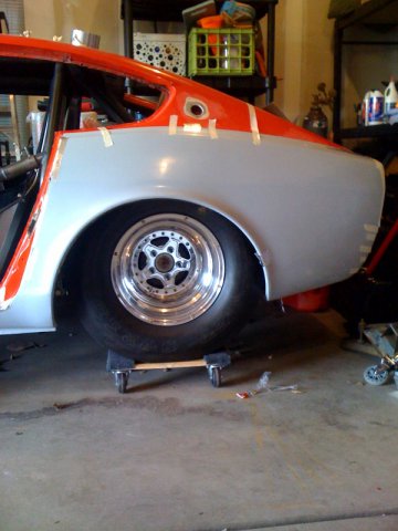

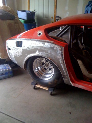

  8. yes... 2 ways either make a curved flange that will be welded to both the inner wheel tub and the outer skin, or like you mentioned cutting little slits and folding each individual slit under and welding it. I'm not concerned how it looks because like mentioned above i'm installing subtle Z 1/4s over it.

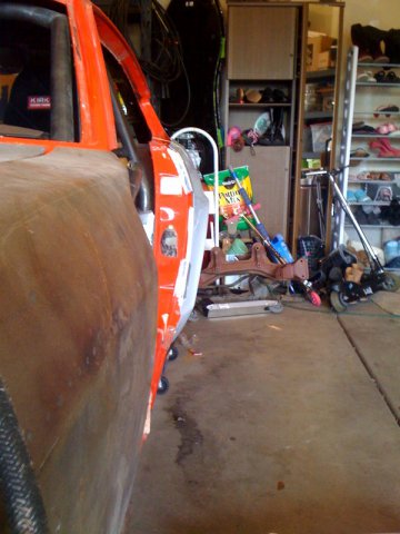

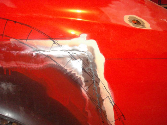

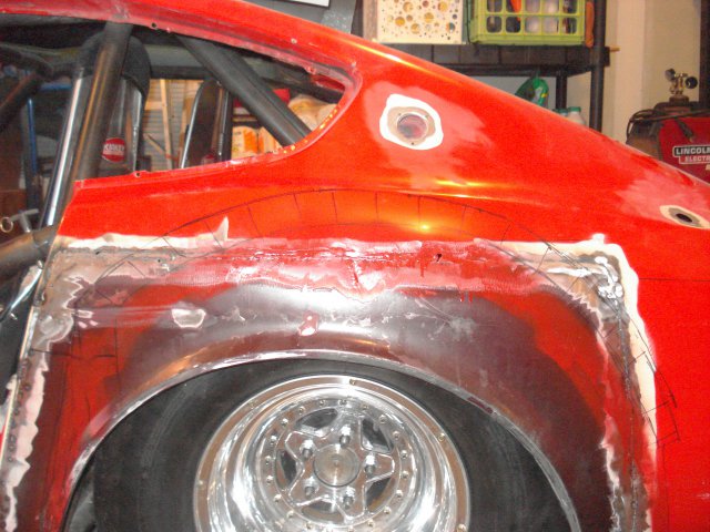

  9. OK here is a better pic of what I'm planning on doing. i have no inner structure that is connected to the outer skin i plan on cutting to the masking tape line then folding under the metal to weld to the wheels tubs which are welded to the chassis. I'm thinking once i do that and bond the fiberglass fender in with panel glue everything will be good. just want to get some opinions. The upper line is the fold line and the lower line is the cut line.

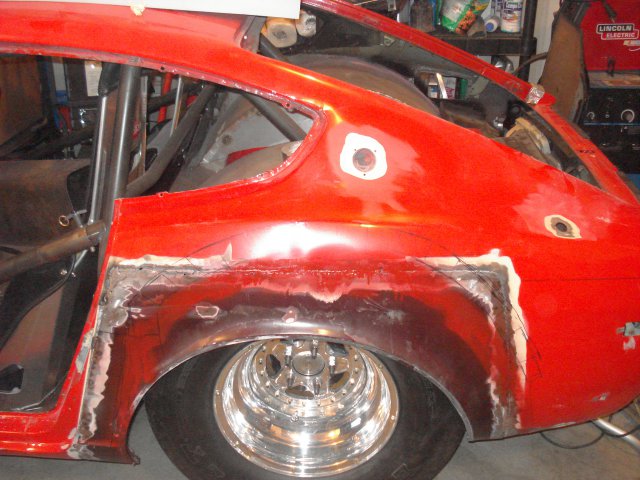

  10. Prepped left rear for the subtle z 1/4s. There was a crap load of bondo in the fenders. glad i decided to do that vs bonding them to the existing stuff. some of the bondo actually broke off as i was grinding!!! Also got some of the front striped of undercoating (this stuff is a BIATCH!!!) and teh dor jams are ready for primer. All the other parts are primed and ready for final sanding and paint. once those get painted the shell goes over.!!!!

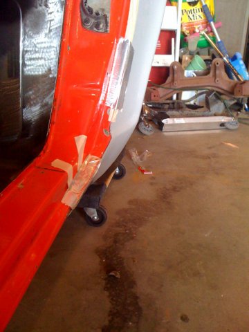

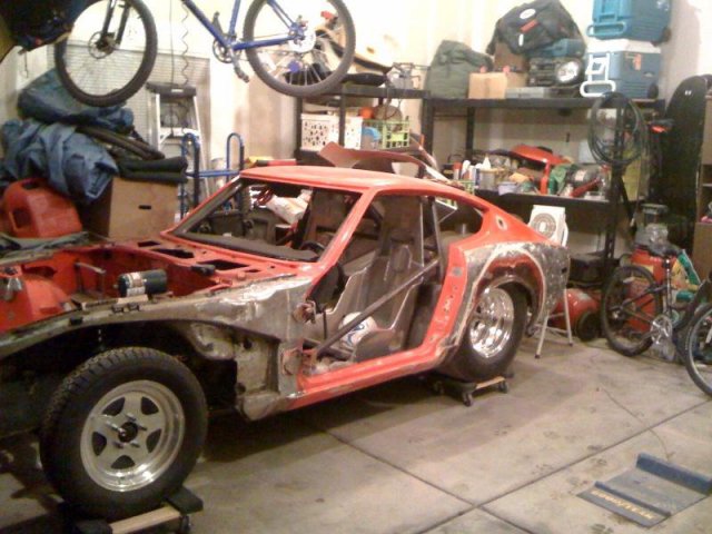

  17. That is how i plan on doing mine. But with a back halve car with huge tubs mine will go a lot higher. my car also has most of the inner structure removed. i was just worried if i took too much out it would the back of the car weak. but if i weld it up to the tubs that should compensate for that right??? the body no longer is a structure the tube frame is. so im thinking it will be alright. here is what it looked like before

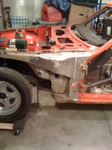

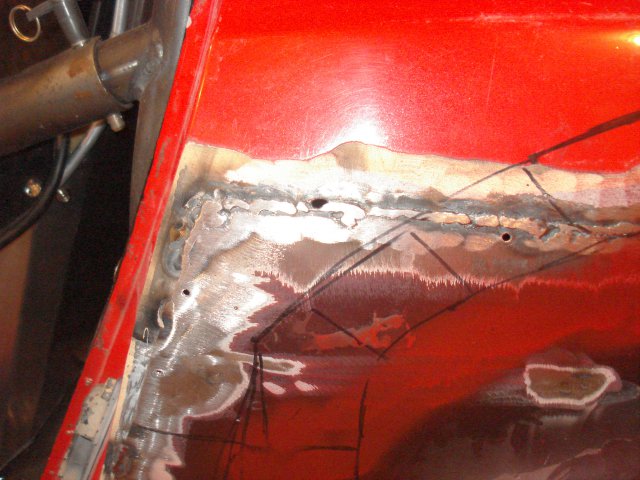

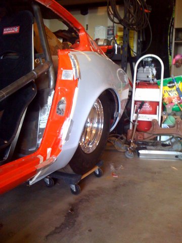

  18. Well my car is a tube chassis drag car. Its connected to the body along the rocker door jam and in the rear of the car. Im going to install subtle Z 1/4's. what I want to do is just like most people do when going with overfenders. cut out the unneeded part of the 1/4 fold it under and weld it to the wheel tub. my problem is the wheel tubs go very high on the body. in the pic below i want to cut to the lower black line and fold the sheet metal under and weld it to the tub. the tub is all welded in and it should make the body more rigid. more so then just adding the frp panel. opinions? too much to remove? Oh BTW got the first 1/4 75% welded in
