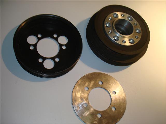

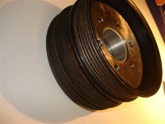

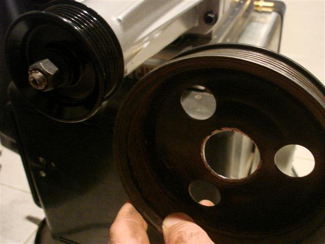

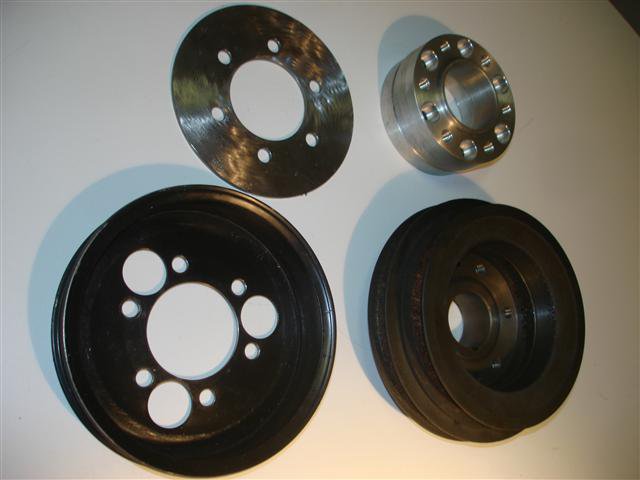

My photos don't show it well but the damper is a two row v-belt off a later 280Z. It was chocked in a lathe and cleaned up on the inside to accept an aluminum insert and allow clearance for the bolt/washer. It's just shy of an interference fit. The plug is held in place with 6 countersunk 8mm socket heads. A GM power steering pulley was modified to fit the pulley lip and sit flush against the outer v-belt flange. The heavy ring clamps the pulley snug. It's modest in ratio providing about 6 psi to get started with. I looked at the BHJ damper but decided to save the cash (at least for the moment). I'll be turning the M62, a/c compressor and alternator. The possibility of power steering also exist as I have a STI PS rack I modified months ago and place back on the shelf. I've followed every thread regarding supercharging and always admired your setup as well as other's designs. My SC sits forward since the snout is only 8" long. The tensioner will take a little creativity. The biggest hurdle now is clearance for the serpentine belt to clear the fan/shrould. I'm thinking I'll be dropping the engine mounts about .375" (to accomodate the .75" taller LD block) and move it back .5" to provide added space up front. The WC T5 shifter (Pro 5.0) can be modified to recenter it in the console. The transmission mount and the diff will likely need shifting to get u-joint angles satisfactory. One step at a time....

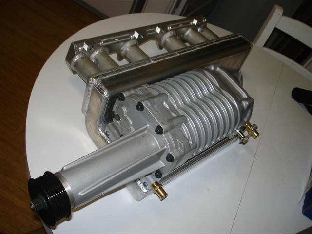

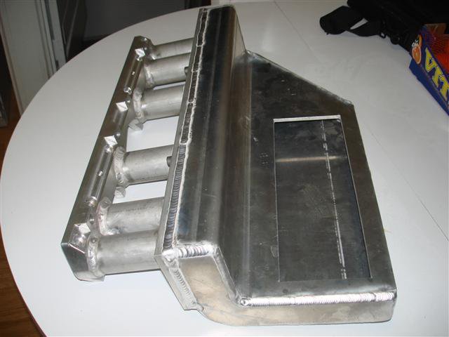

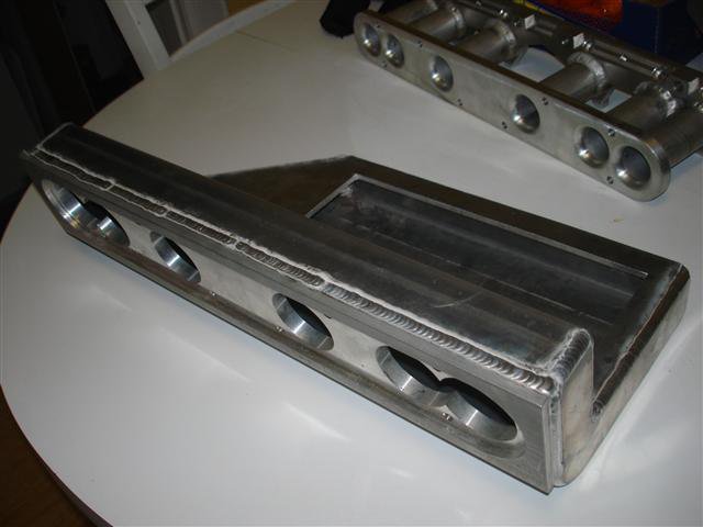

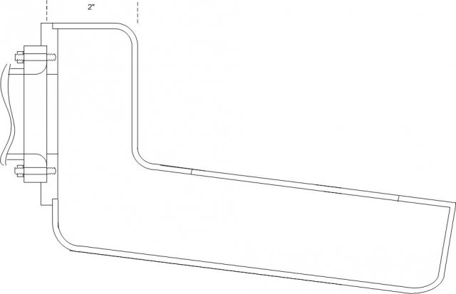

I haven't fitted it under the hood as my 240Z is fully functional right now. You can't tell from the pictures but the plenum actually tilts downward about seven degrees to account for the engine lean. That lets the SC sit flat and looks better too. I'll slap it on the long block tomorrow or Saturday and take a couple more pictures. There were numerous measurements taken to ensure clearance at the strut tower and under the PDK strut bars. It sits below the valve cover height and strut bar so hood clearance is a non issue. I decided to build the intake in two pieces so the runner and header hardware would be easily accessed. It weighs quite a bit despite being aluminum. An adjustable brace will come up from the a/c compressor bracket to support the outer edge weight and provide additional stability. I'll have to work out cold air ducting.

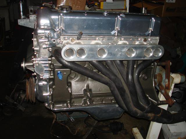

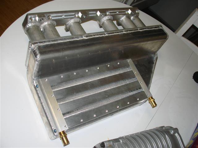

I finally got the intake system worked out...almost. I still have to machine the spacer between the aftercooler and supercharger and sort out the belt drive system. The engine is a LD28 block and V07 crank mated to a P90A head and uses JE pistons and L20B rods for a displacement just over 2.8 liters. After all the time and money spent on an old chunk of L6 iron I keep hearing the "I shoulda had a V8" juice commercial in my head.

A full length metal\composite shield will be installed to deflect radiant heat. I personally do not like header wrap. My header is an old school Janspeed S\S 6-2-1 so a coating is out of the question too. The header in the photo is just a spare piece lying around for mock-up. Some sort of air duct will likely be incorporated to feed cool air into the intake\exhaust area. The inspection covers are louvered. The hood has a Nissan competition hood scoop and the hood has two rows of louvers to vent out heat.

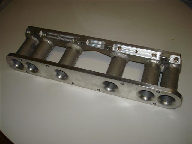

Actually, I just had these produced in the last month. One was needed one for my SC'd L28 stroker project. I figured I'd have four made to help others and offset the cost a little.

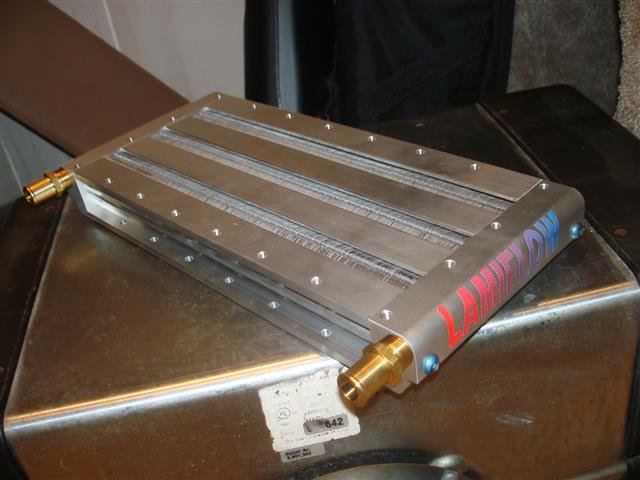

I'm using a Laminova three core aftercooler built by Rick Zimmer at www.boostecus.com for my SC'd L28 240Z. This is a mere 14" x 6" x 1.6" and rated to approximately 350hp. It is sandwiched between the SC and the plenum. A 12 volt pump, reservoir, hoses and a small radiator (around 20" x 6" x 1") will complete the system. No problems with long complex piping or giant intercoolers. Cost will come in around $1200.
Thanks. I found my way to your supercharger boost calculation post. I came up with approximately 5.9 psi of boost with my pulleys. I'll start with this lower boost and see how the engine performs. Compared to the 2.4 N/A with a 272 Crane cam this 2.8 should be a lot more interesting. Upgrading to a larger crank pulley would not be a difficult task if it is warranted. A reliable spirited vehicle is all I want to achieve. Trying to beat every vehicle at every stoplight ended years ago. L28 SC.bmp
It has been over two years in the making but I'm moving closer to a finished LD28/P90A supercharged L6. The plenum is in the works at a local metalsmith. It will bolt up to Justin Olson's intake flange. The Laminova water/air aftercooler is finished and will sandwich between the plenum and M62 SC. That brings me to the crankshaft pulley. I labored for a cost effective means to procure a pulley without machining one. What I came up with should fit the bill. The stock two pulley damper will be machined out slightly to provide a uniform smooth inner bore and drilled in a six bolt pattern to fit a cylinder shaped plug (it then goes to damper doctor for an overhaul). That plug will sit flush with the surface of the outer pulley and have a protruding step to provide a hub for centering the 6-rib pulley. I'm using a reworked GM 24500426 power steering pump steel pulley. The center shaft sleeve was pressed out and then I pressed the whole center section flat in my press. It needs to be chocked in the lathe and turned to open the center uniformly and drilled to bolt to the damper. Another thin spacer will sandwich the pulley to provide reinforcement. It measures 17.125 around the ribs. The SC is 8.75 giving a 1.957:1 ratio. I think that should provide about 8psi boost. This has been a long expensive exercise in frustration. I'm thinking I'll have to push the engine back 1" and down about .5" to provide clearnce for the SC belt/pulley to fan and account for the .75" additional height of the LD28 block (note the V07 casting number in the engine photo).
