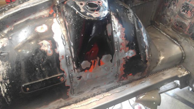

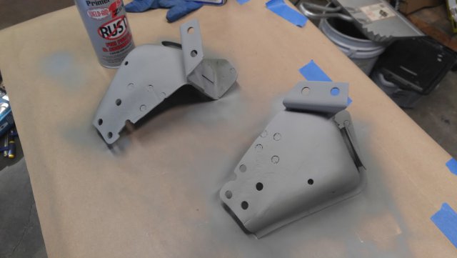

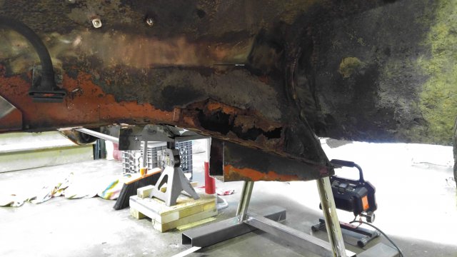

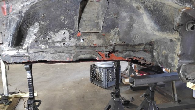

So the last few weekends I've started tackling the driver's side rocker replacement. After drilling out many, many spot welds I found that the "tie in panels" (which I didn't even know where there) were rotted out as well. Picked up a set from Prospect-D to save myself some fabrication time, and have been working on removing the rotten metal , treating, and replacing. I also found that the lower portion of the rear inner fender was completed rotted out; so that's another panel I'll have to make from scratch, but I'll get to that after the rockers are back in. Looks like the PO was well aware of the rot in this area... as he came up with a rather "Home Depot" approach to repair. What metal was left was brushed down the best I could with wire wheels, and then ospho'd twice, followed by rust converter for anything else I missed, then weld thru and normal primer. three days of curing just to get through the primer stages! ugh, le lame. Album: https://imgur.com/a/SkwkJ

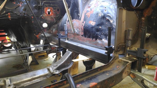

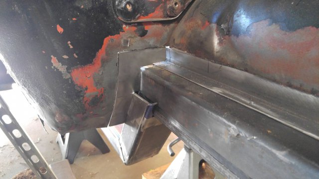

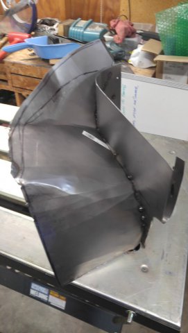

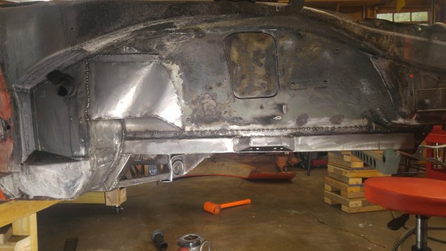

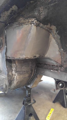

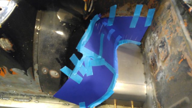

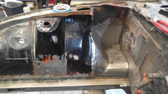

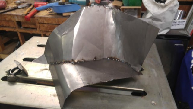

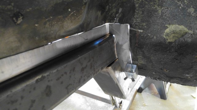

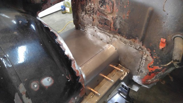

I've also spent some time on the passenger side inner fender, made a new panel where the battery tray was...which i'll probably end up mounting in the back of the car. Will wait until fuel tank is in and see how much room I've got. ANYWAY, did most of the forming over my knee with a bunch of hammer and dolley work. Also stitch welded the first strut tower, and did a bunch of welding on the new frame rails and fender tie ins:

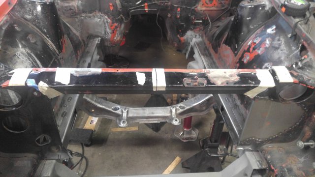

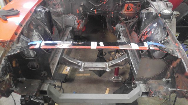

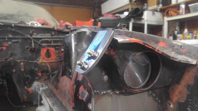

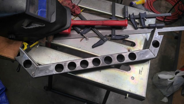

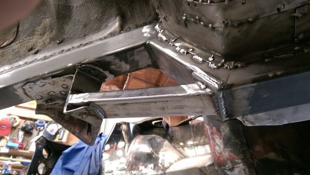

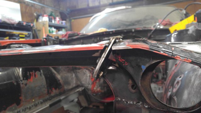

Making the upper radiator support removable. I HATE the wiggle of getting an engine and transmission out of an engine bay. Should have used some wider metal so I wouln't have to worry about the gap at the front but I'll address that later. Trimmed and ground tabs, it's reasonably flush now.

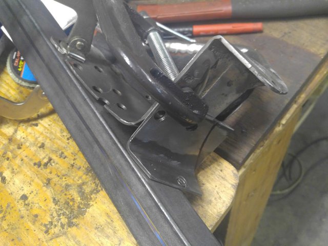

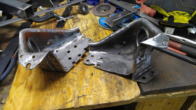

Then I made a new radiator lower support bracket to accommodate the larger Howe radiator I'll be using, and strengthen the area for the next step...

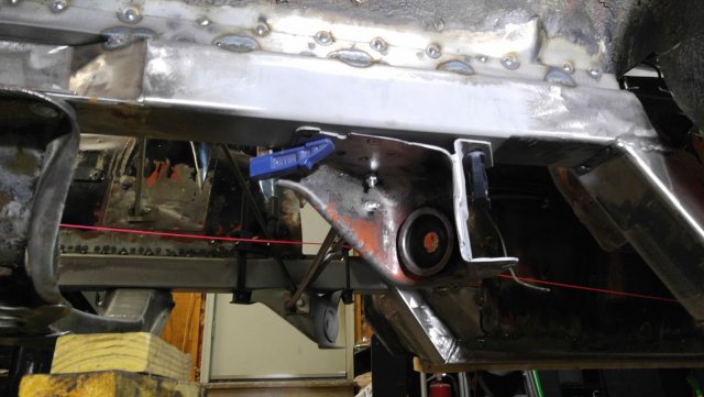

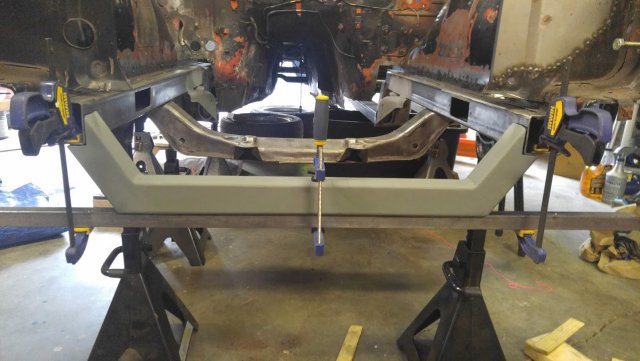

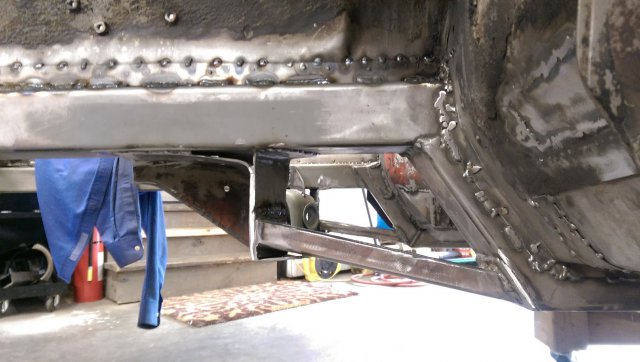

I drilled two sets of cross member and sway bar mounts, the second set 1" further forward from stock... Should I ever decide to push for high caster angles - not exactly sure why i'd do that, I think I read it on blueovalz's build and said to myself "well gee Tim, since you're here... drill the extra holes." All the various pieces started going back together.

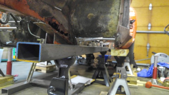

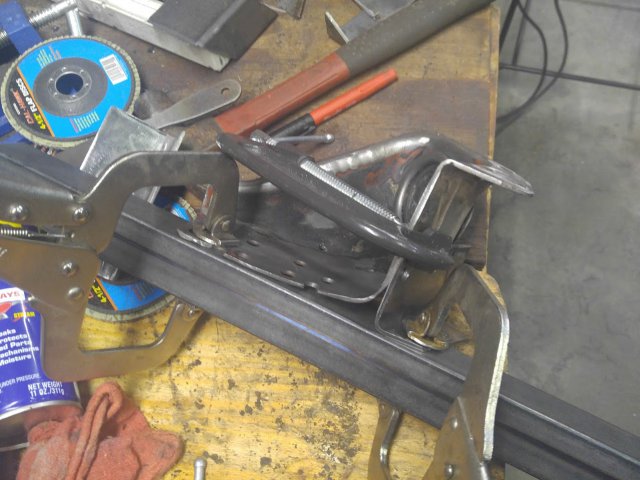

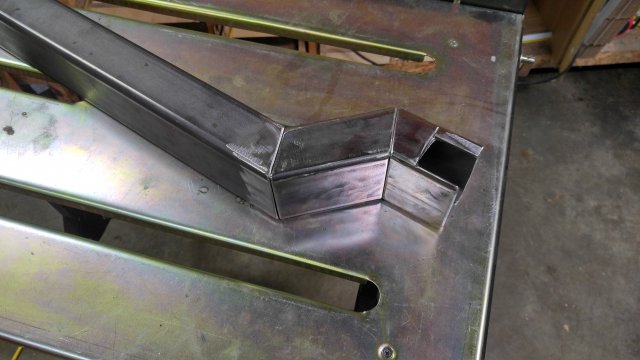

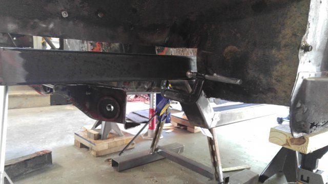

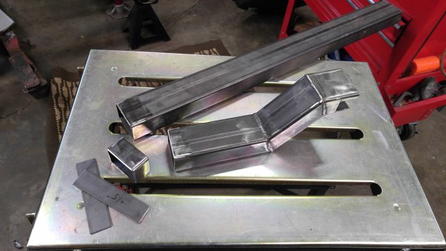

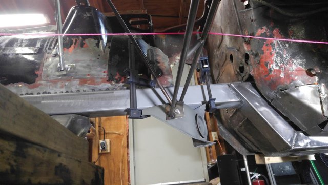

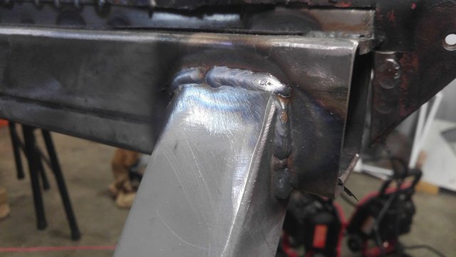

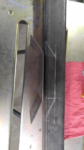

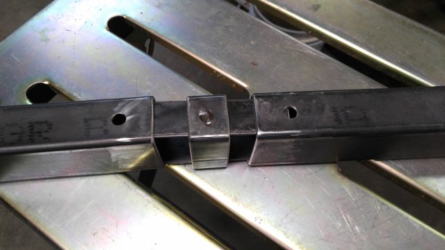

At which point I realized I fucked up and cut the main length too short, the riser to the engine bay rails would protrude 1.5 inches into the cabin, hitting the throttle pedal. So, had to extend it out. Added in the extension at a point on the length where I thought it would see the least stress - around the seat mounts which I was planning on redoing out of tube too.

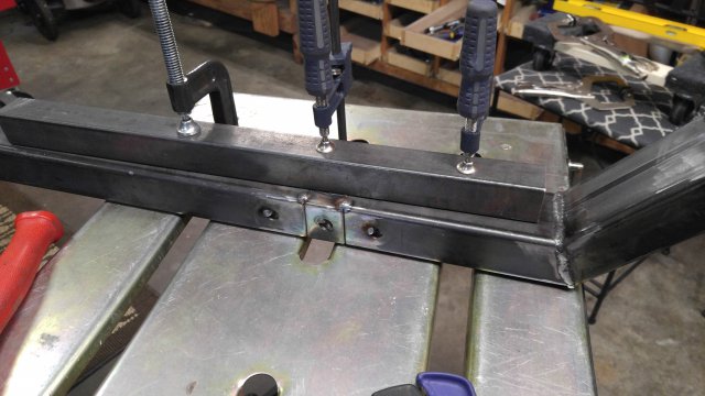

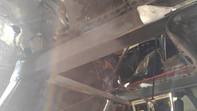

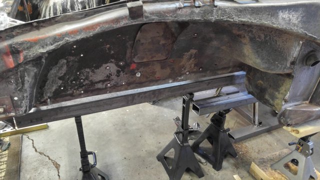

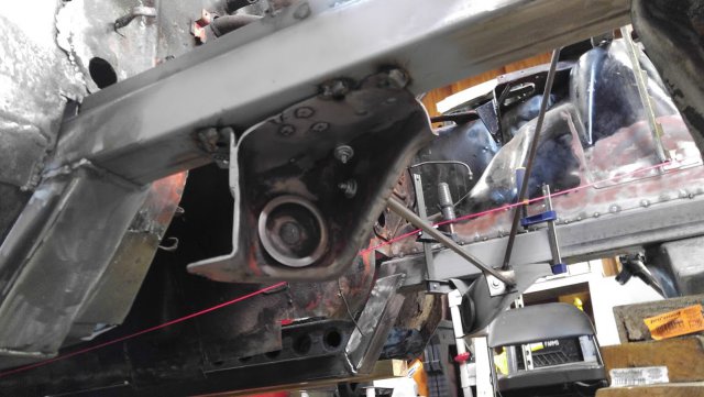

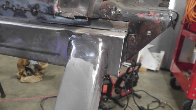

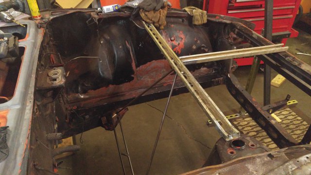

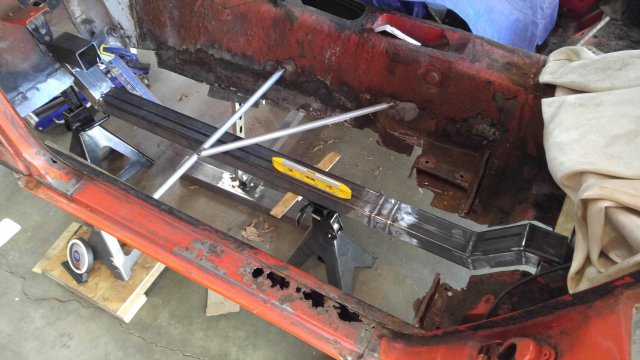

And then I went AH **** IT at which point the car went from "get back driving and not immediately die" to "time to get not shitty at fabrication and build a car to a level you haven't done before." I've done a dozen engine swaps, rewires, fuel systems... but never this much metal work. Made a jig to locate TC buckets and made the main floor rails out of 2x3 .125 IIRC. Lots of time spent getting things level in an unlevel garage, measuring, making sure things are as square as possible. Lots of mocking up, looking at it for a few weeks, a couple tack welds, adjust...look...think...undo...redo..think...drink beer... From the time I started cutting the rotten frame rails out to the time they were fully welded in was a bit over a year.

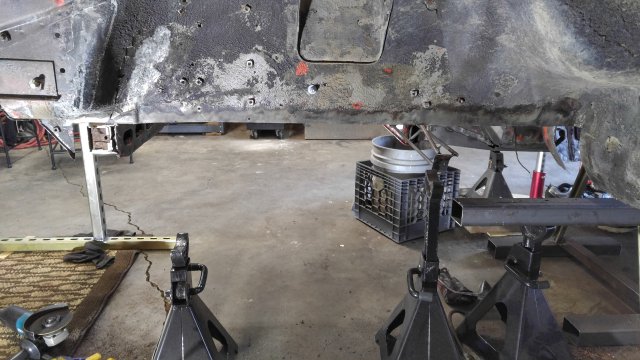

Floor boards before I wised up and cut everything out. Even bought Bad Dog frame rail reinforcements...

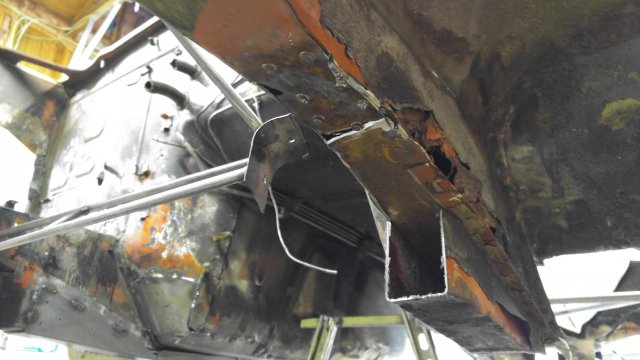

At first, began tearing it down. Thought I could redo the floors, and patch the necessary areas of rust in the engine bay and frame rails. Eh... not so much.
