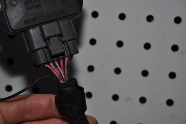

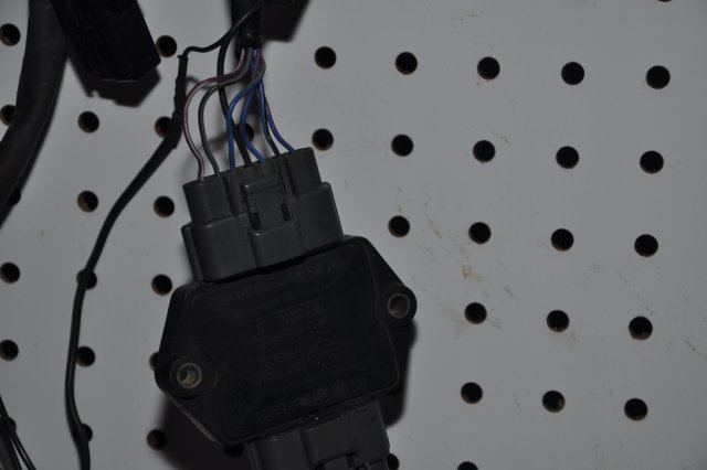

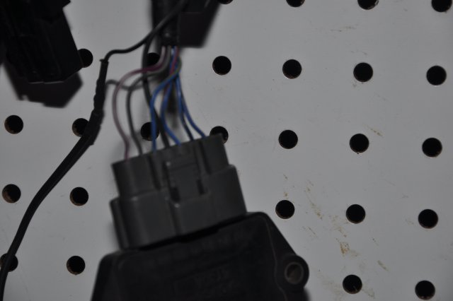

  19. I personally used an infinity J30 but i belive that is the same one. You can get the harness and the ignitor on ebay for a few bux. I think i paid 28 shipped for mine. ill take some pics if you like i have my wiring harness on a pegboard in my living room sitting next to me, lol.
