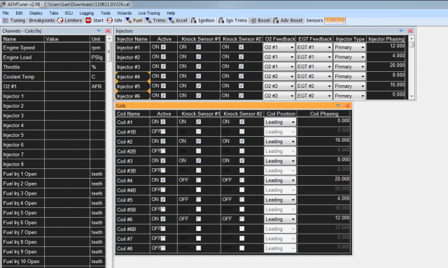

  10. pm me your email address. it willnt let up upload the cal. Attached is an older one of mine usings the following setup OEM rb26 440cc injectors on a peak hold driver.... You will need to change this according to your injector needs. i am thinking you have HKS Fuel Injectors (1402-RA002) Injector Top Feed Includes Injector Harness Connector Color : Light Blue Flow Rate : 1000cc Style : Low Impedance In which case i would find the specs on them to see the resistance and all but you might could use a percision or RC or something low impedence to get it on the trailer. AEM 3.5 map sensor. Being that you using a 5 bar this will totally change the tune. you can interpolate if you like and you can probably get her running enough to get it on the trailer. A little trick you can use is to copy the igntion map and the fuel map to a picture file and then go to the setup wizard and change to a 5 bar. then pull up your pictures and kinda figure out what the values need to be. (it changes the Y axis). probably go though the setup wizard and select all your engine specific stuff.

  13. Do you have the battery offsets for those injectors?
  14. What brand injectors? Still using your resistor box? what is your map sensor? 3.5 bar aem, 5 bar aem, gm 3 bar, ect? edit, also post your current tune.

  19. ohm the signal wires for the coils and injectors and make sure the order is correct, ie coil 4 signal ecu pin is actually the number 4 coil.
  20. Is the car running? If not... This is a complete hip shot so take it with a grain of salt but wouldn't you look at the ignition map at like 500 rpm (close to cranking speed) that would be where your ignition is fired. Is the little key on the exhaust cam still intact? Go to the setup wizard and select the nissan 6 cylinder cam sensor. Compression test? You know how to set the igntion with just twisting the cam right. If it is running you need to sync the time to what it is actually reading via a timing light.
  21. I would just call a big chassis manufacturer and have them build a chassis then drop your shell on it. All you need is the 240/60/80 wheelbase length. Put me down for one if you do call anyone I will take one as well.
  22. Be careful loading other tunes, make sure you go though it really good. Have you checked the phasing?
  23. Is the Stat sync box in the AEM tuner on?
