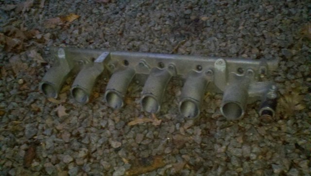

R3VO 3VOM Posted November 29, 2012 Share Posted November 29, 2012 I was thinking about this today. It woulnd't be "that" hard. The real factor would be how cheap you could get the carbs for and how much fabrication do you want to do. Tripples aren't cheap in any sense. You could get a motorset like this: http://www.ebay.com/...1dd8ffd&vxp=mtr For the intake, you could do something like I was going to do before I realized the holes on my 26 intake lined up. Take the stock lower intake and cut it down (the runners would probably have to be shorter since runner 1 kicks up higher at the length I have them than the rest), get some flanges made that match the carbs and bolt them on. this way you keep the coolant sensors. You'd need the plug the fuel injector holes and figure out a throttle linkage. The other problem would be the spacing of the runners and the spacing on the carbs; if the runners will line up with the carbs or not. Quote Link to comment Share on other sites More sharing options...
