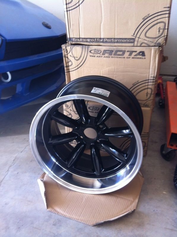

dreco Posted December 27, 2012 Author Share Posted December 27, 2012 (edited) Pics? sorry, Theyre at the shop. Went down to inspect them but completely forgot to snap pictures haha. I'll probably get to it this weekend. FYI I got them in Royal Black with the Polished lip. Edited December 27, 2012 by dreco Quote Link to comment Share on other sites More sharing options...

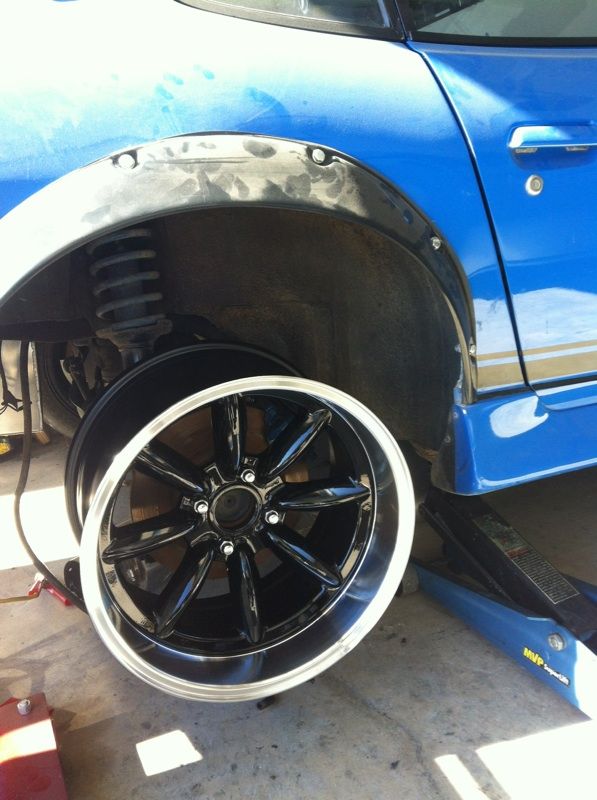

dreco Posted January 7, 2013 Author Share Posted January 7, 2013 put them on to see how they'll fit. Quote Link to comment Share on other sites More sharing options...
Never2BeFinished Posted March 28, 2013 Share Posted March 28, 2013 Those look fantastic! im considering those same wheels and size and color...since those are the widest 4 lug wheels i could find that arent custom Any fitment issues? Quote Link to comment Share on other sites More sharing options...
