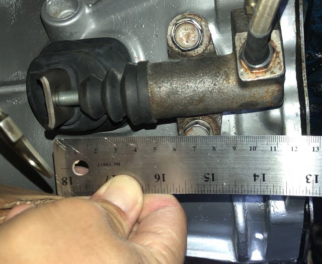

I have struggled with the Clutch Slave Cylinder.
https://youtu.be/C-_NZFeVp1I
It always almost fully extended.
I replace the Clutch Slave Cylinder with cheap CENTRIC 139.42002 from Rockauto.com. It costs $6.32.....
I replace Clutch Master Cylinder to 15/17 version from 280ZX too.
Today, I purchased Genuine Clutch Slave Cylinder from Nissan Parts center.
It still available to purchase. It costs $75....
I compare the size with aftermarket Clutch Slave Cylinder.
The aftermarket cylinder has stronger and longer spring inside. The rod length is almost same.
due to the spring, the default length is longer than OEM version.
This could be the reason, the slave cylinder is pushing too much on the fork.
Edited by tamo3
Here is a picture I took a while ago that might help you figure out where your problem is.  It's the distance from the clutch fork to the head of one of the slave cylinder mounting bolts, on a properly working clutch system.  It should tell you if you have the correct TOB sleeve inside.  A short sleeve will measure more than 6 cm, a too-tall one will measure less.
This is the starting point, and travel is fine.
Seems like that should work fine.  A few mm there will probably be less than one mm at the TBO due to the ratio of the fork.
It's not clear what problem that you're having.  I watched your video and see that the piston is far down its stroke.  But I don't know what the total stroke length is.  Are you saying that when you press the pedal the fork doesn't move?  If you were at the the end of the stroke the piston should pop out of the bore.
My picture was taken with the pedal up.  It was just me, a steel rule, and a camera.
I'm going to go out and see if I can push the rod and piston back as far as you do in your video.
