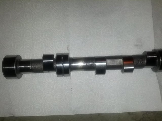

inline6 Posted August 22, 2013 Author Share Posted August 22, 2013 The new cam came in. Oil holes are in interesting locations... Many are in close proximity to the center of the base circle. Some are closer to the opening ramp. And 2 and 11 are just after the closing ramp. Sheesh. Can no one get that right? Was going to work on installing it tonight, but unfortunately there is no rear oil galley plug. Going to have to take it to a machine shop to get it drilled and tapped for a 3/8" NPT. There are a couple of Datsun shops around this area (north Atlanta), right? Garrett Quote Link to comment Share on other sites More sharing options...
