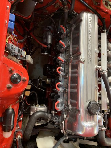

madkaw Posted March 17, 2019 Author Share Posted March 17, 2019 New wires look pretty too Quote Link to comment Share on other sites More sharing options...
HuD 91gt Posted March 17, 2019 Share Posted March 17, 2019 Those are the 6” wires? Glad and to see it up and running. Curious to see how your going to get that Jeep CAS connected. Quote Link to comment Share on other sites More sharing options...
madkaw Posted March 18, 2019 Author Share Posted March 18, 2019 The pic is of the new MSD wires Quote Link to comment Share on other sites More sharing options...
HuD 91gt Posted March 18, 2019 Share Posted March 18, 2019 Yes. They seem to come in 6” and 12” lengths for LS coils commonly. Are those the 6” leads, or something different? Quote Link to comment Share on other sites More sharing options...
madkaw Posted March 19, 2019 Author Share Posted March 19, 2019 6” maybe. I think total length of the wire is 10” . I think they are sized for the corvette. They are actually shorter then the ones I took off which were for the truck LS motor. Not sure about all the differences in the sizes. Quote Link to comment Share on other sites More sharing options...
