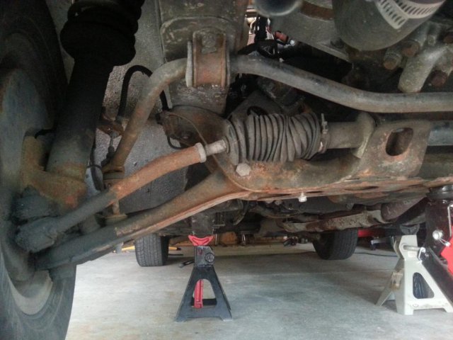

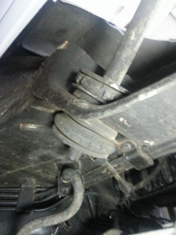

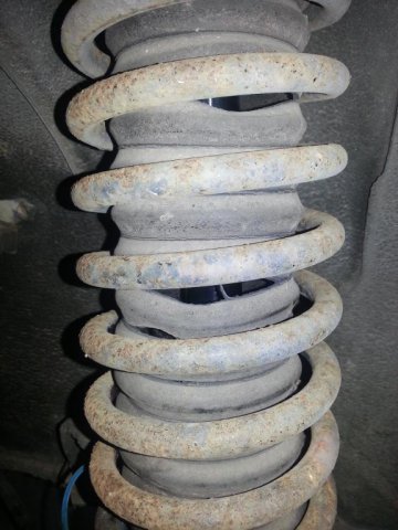

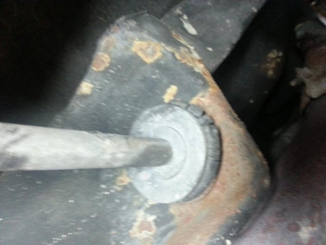

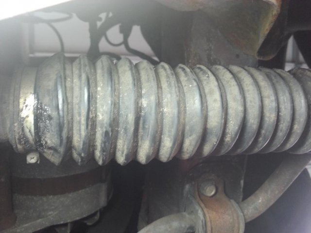

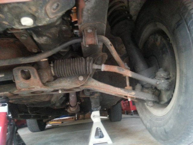

Glliw Posted August 4, 2013 Author Share Posted August 4, 2013 I had a chance to take a look at this again today and no broken suspension parts down there. Looks like I could use a new boot on the right side of the steering arm though as its got a small tear in it. What I'm thinking after reading through this and the FSM some is that the sound may be from the fact that the front shocks are blown thus causing some abnormal movements, but also all the blown bushings on the car. It looks like pretty much every bushing has seen better days. Here's some shots of what I saw down there. I say its a safe bet that some tokico HPs, Eibach springs, and an poly-bushing kit are in the near future for this car. Quote Link to comment Share on other sites More sharing options...

NewZed Posted August 4, 2013 Share Posted August 4, 2013 In the second picture, your steering link and ARB look like they have rub marks on them, maybe from the tire. Fits the right turn scenario. Quote Link to comment Share on other sites More sharing options...
Glliw Posted August 4, 2013 Author Share Posted August 4, 2013 Sorry, but ARB = ? Quote Link to comment Share on other sites More sharing options...
NewZed Posted August 4, 2013 Share Posted August 4, 2013 (edited) Anti-roll bar aka sway bar aka anti-sway bar. Funny, I asked the exact same question many posts ago, now I'm on the other side. Crank the wheel to the right and see how close the tire is to those parts. I'm not sure but I think that if you're steering rack was misplaced it would change the "lock" on one side. The rack bushings on these cars degrade and the rack moves around. Makes the steering loose. Edit - rack might not be the right word, since the actual rack is inside. Maybe rack housing? Anyway... Edited August 4, 2013 by NewZed Quote Link to comment Share on other sites More sharing options...
