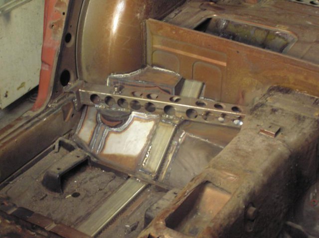

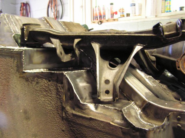

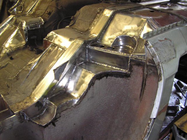

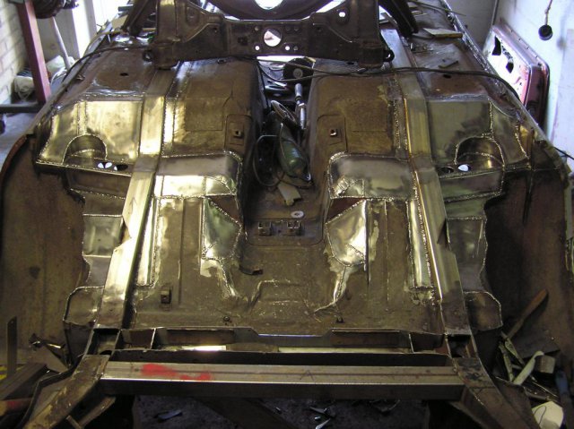

TUME Posted March 29, 2015 Share Posted March 29, 2015 (edited) Here is some pics about my swap. I wouldn´t say it was easy, but there is many ways to do this. As we can see.... Edited March 29, 2015 by TUME Quote Link to comment Share on other sites More sharing options...

tube80z Posted April 6, 2015 Share Posted April 6, 2015 Here is some pics about my swap. I wouldn´t say it was easy, but there is many ways to do this. As we can see.... It looks like if you modified the stock 240SX cradle this would be easier to do. I'm guessing there's an opportunity for an enterprising individual. Cary Quote Link to comment Share on other sites More sharing options...
TUME Posted April 6, 2015 Share Posted April 6, 2015 (edited) It looks like if you modified the stock 240SX cradle this would be easier to do. I'm guessing there's an opportunity for an enterprising individual. Cary I thought that too, unfortunately it came in my mind too late. I did little modification on my subframe afterwards, lowered LCA front pick-up point to reduce anti-squat. After that i noticed there is unnecessary notch in my chassis because of that... When I was saying there is many ways to do this modification, I meant mainly suspension geometry. If you want decent roll-center and low car you must install subframe deep in your car. It means lots of metal working... Edited April 6, 2015 by TUME Quote Link to comment Share on other sites More sharing options...
grayson260z Posted April 14, 2015 Author Share Posted April 14, 2015 the rear most mounting points for the subframe look easily done with just that bar across where the spare tire well was. Correct me if I'm wrong of course though. the front if im seeing it right goes into the lower mounting "hole" for the bottom part of the seat belt. That area on ours was pretty rusty though. I'll try to get back to the shop here soon and reevaluate the subframe. Thanks for the replies! Quote Link to comment Share on other sites More sharing options...

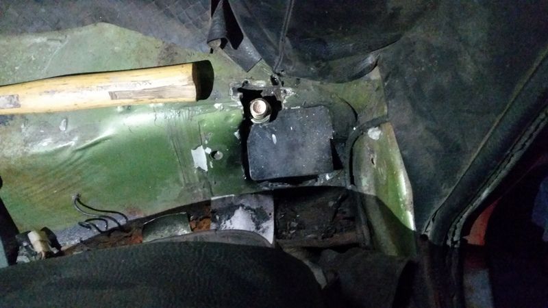

TUME Posted April 14, 2015 Share Posted April 14, 2015 the rear most mounting points for the subframe look easily done with just that bar across where the spare tire well was. Correct me if I'm wrong of course though. the front if im seeing it right goes into the lower mounting "hole" for the bottom part of the seat belt. That area on ours was pretty rusty though. I'll try to get back to the shop here soon and reevaluate the subframe. Thanks for the replies! U got that right, sir. Here is a poor pic inside car. As you can see, seat belt rollers can´t be there anymore. Quote Link to comment Share on other sites More sharing options...
RPS30.Drvr Posted December 18, 2015 Share Posted December 18, 2015 (edited) the rear most mounting points for the subframe look easily done with just that bar across where the spare tire well was. Correct me if I'm wrong of course though. the front if im seeing it right goes into the lower mounting "hole" for the bottom part of the seat belt. That area on ours was pretty rusty though. I'll try to get back to the shop here soon and reevaluate the subframe. Thanks for the replies! Yes the rear part on a bar near where the spare tire was pretty easy. Yes right in the seat belt retractor pocket. I cut mine out. Edited December 18, 2015 by RPS30.Drvr Quote Link to comment Share on other sites More sharing options...
