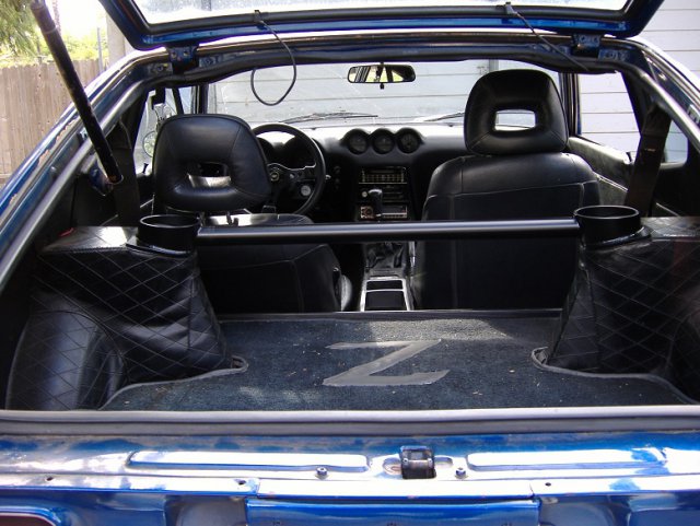

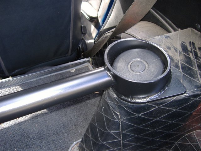

Miles Posted March 11, 2014 Share Posted March 11, 2014 How about this: Quote Link to comment Share on other sites More sharing options...
Graphitez Posted March 12, 2014 Share Posted March 12, 2014 ok I really like your design. Quote Link to comment Share on other sites More sharing options...
