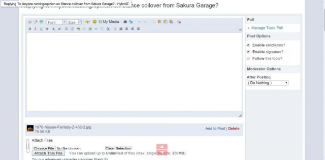

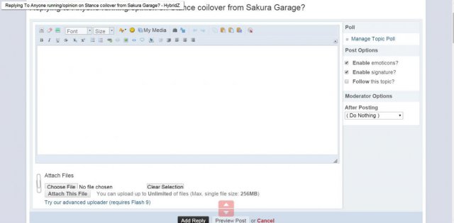

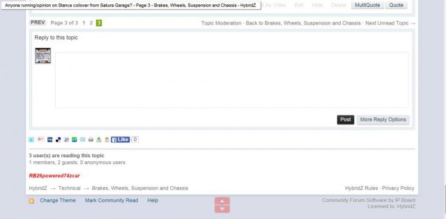

RB26powered74zcar Posted February 17, 2016 Share Posted February 17, 2016 Upload pics from your computer by first going to the bottom right of the message window and clicking the More Reply Options CLICK Then go to Attach Files at left bottom and click Choose File. This will open a folder on your computer that has all your picture files in it. If not, then you will need to find that folder. Once you see your pic/s, click on the pic and it will transfer the file name into the area by Attach File. Keep adding pics if you have more than one. Click on Add To Post to put each pic in the message window, then click Add Reply CLICK Quote Link to comment Share on other sites More sharing options...

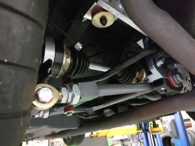

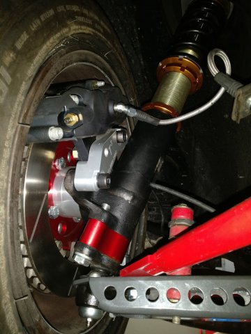

kona41 Posted July 6, 2016 Author Share Posted July 6, 2016 So here is some of the progress. Slow but steady. The front spindles are out getting welded. The rear collars are welded to the carriers. The front shock towers are cut and the camber plates and vanity plates are installed. I had the vanity plates powder coated to match the car. Currently putting rear wheel bearings together so I can start buttoning up the rears. Subaru diff and wolfcreekracing cv's to go in, along with T3 Rlca, dogbone and drop mounts and Ron Tyler diff mount. T3 rear disc kit mocked up. And fml. Z con in August.... And I still do not have a suspension in the car. Lol. Time is the commodity here. Quote Link to comment Share on other sites More sharing options...

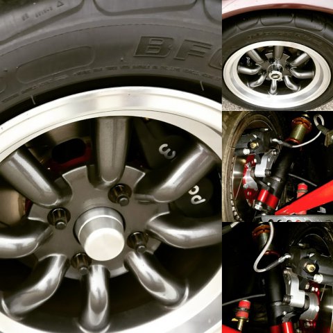

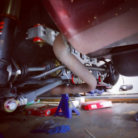

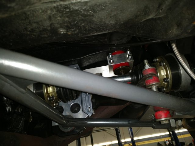

kona41 Posted March 27, 2018 Author Share Posted March 27, 2018 So I know its been a long time but lots of progress was made last summer, and I was back driving the car. T3 control arms front and rear, tension rods, steering coupler, moustache bar, drop mounts, installed along with Wolf Creek Racing CV's, STI stub axel adapters, r180 STI diff, RT diff mount, T# big brake kit front and rear....... April the car goes for body work, repaint and some other goodies. Car was aligned and corner balanced this past fall, and I cannot get over the change in mechanical grip. Suspension and CVs are loud but that comes with the territory. Big spring for the car. I have been bad at updating on here, but feel that I owe it. check me on instagram for updates @theburbankbuild_s30 Quote Link to comment Share on other sites More sharing options...

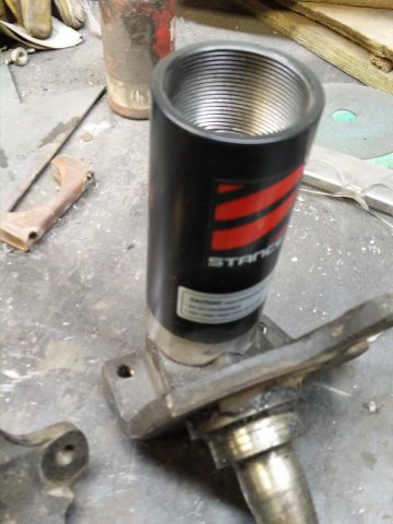

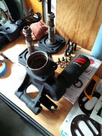

JeffB240z Posted June 26, 2018 Share Posted June 26, 2018 I'm about the order some coil and am between BC's and these. This thread may have pushed me towards these! I was curious if the threaded tube comes notched to clear the hump on the spindle. Shown in this picture, can you confirm that the notch came precut, or is this a cut that you had to make? Thanks! Quote Link to comment Share on other sites More sharing options...
JeffB240z Posted June 26, 2018 Share Posted June 26, 2018 Sorry, this picture... Quote Link to comment Share on other sites More sharing options...
cgsheen Posted June 28, 2018 Share Posted June 28, 2018 No, the Stance USA threaded adapter is not pre-cut for an S30 front hub. If you are welding to the hub, you'd need to notch the adapter as required. Quote Link to comment Share on other sites More sharing options...
