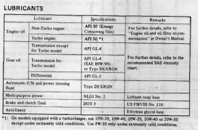

Borg and Warner T5 that came in the turbo 81-83 280zx were supposed to have ATF ran in them not gear oil.  He is noticing a difference is shift quality now that he's figured it out i suppose.
Actually that's not clear from the Nissan service specs., and that's where the confusion comes from.  Plus the fact that some BW manual transmissions specify Dexron, according to the interweb.  See attachment for Nissan spec.  Notice that Nissan calls out the automatic transmission specifically right below the manual transmission spec.  It's just a poorly written specification.
Here's a pretty good summary that throws in the confusing point with no clarification.  World class versus non world class, but who knows if that's true.   Nissan calls out either fluid in their spec.  Maybe Nissan used both WC and NWC in their turbo cars and the owner is supposed to know which they have.  It's a mess.
