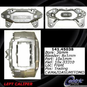

andyhorror Posted November 11, 2014 Share Posted November 11, 2014 Was helping a buddy at the shop with the brakes on his lsx rx7, when i picked up one of the calipers. WOW are they light. all aluminum four piston fixed caliper and they're cheap at 35 a piece. so i was wondering if this would be another budget upgrade option. after some looking seems to be a fairly popular upgrade for the ae86 guys. im a long ways off from brakes but i wanted to put this up to see if anyone had opinions. Quote Link to comment Share on other sites More sharing options...

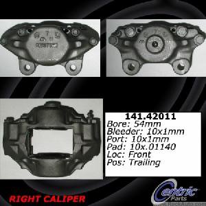

socorob Posted November 11, 2014 Share Posted November 11, 2014 I had these on an old british car with no power assist. Aren't the pistons small on these? Quote Link to comment Share on other sites More sharing options...

andyhorror Posted November 12, 2014 Author Share Posted November 12, 2014 yes socorob they are smaller but four equal out to more surface area than 1 big piston. just like 4 valves be betta than two Quote Link to comment Share on other sites More sharing options...

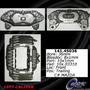

helghast7 Posted November 12, 2014 Share Posted November 12, 2014 (edited) Always interesting to see people here have use for Rx-7 parts. Little info on these calipers for those that want to try this out. Both FC (87-91) turbo and FD(93-95) came with the 4 piston fixed front calipers which are completely interchangeable. The ONLY difference between the 2 models is the older FC calipers had cooling fins on them. However after much discussion and testing on Rx7club they found minimal gains at best for the older cooling fin type, so really any ones you get will be fine. Just have to grind off the mazda emblems on them lol. Oh I almost forgot, just as people say here that our stock brakes are good for decent power, for the FD they tell you on rx7club that the factory brakes with good pads and rotors are good for up to but not maxed out at 500whp before any real brake fade would be noticed and thats coming from a car that weighs roughly 2800 lbs wet factory. Edited November 12, 2014 by helghast7 Quote Link to comment Share on other sites More sharing options...
